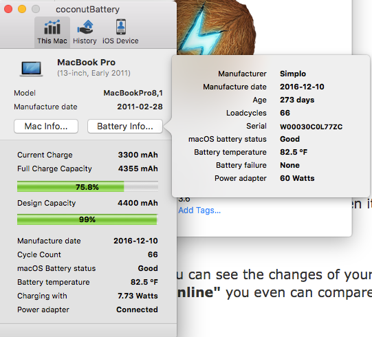

Here's a screenshot from CoconutBattery

That battery looks fine -- 99% of design capacity.
But... be careful to get it back on charge before it dies.
Perhaps the previous owner changed it before selling it.

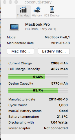

Is the Macbook a 13"? The battery in my early 2011 13" has a design capacity of 5770 mAh. There are 1,030 cycles and full charge capacity is down to 4,287 mAh but battery is good. These values are from coconut battery.

Yeah, it's a 13". It appears that indeed the battery was changed before I purchased the machine - perhaps it's just not playing nice with it anymore? I just wonder why it has suddenly decided to start doing this, when there were no issues at all with the battery dying the first few months I had it.
Batteries can be unpredictable and it does appear that the Macbook doesn't have the original battery.
I changed my battery a year and a half ago, bought from eBay, and my capacity is the same as Audit13 has and working swell.
The battery is obviously changed but not to the same specs. Don´t know if this is the problem, but it can´t be helping.
You've got a crappy after market battery in your MBP. The manufacture date of the battery is 2016-12-10.
Your solution is probably not to let the battery totally discharge or get a different battery.
