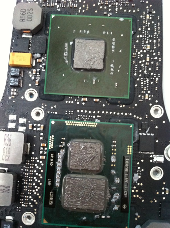

Messy job by Apple:
attachment.php

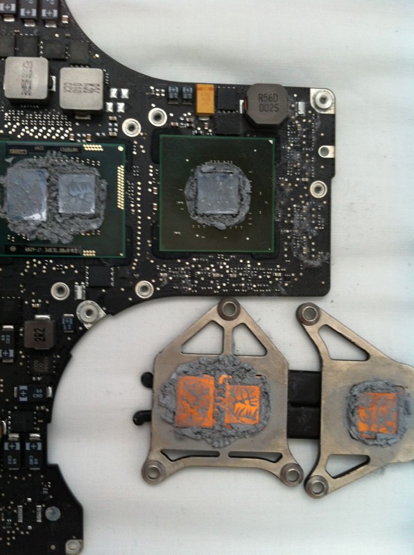

My clean up job:
attachment.php

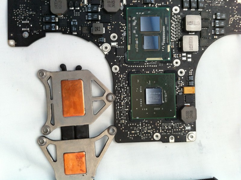

And my reapplied AS5:
attachment.php

looks like you did a pretty nice job, i'm also curious about your temp improvement.
Initially, my temps have dropped by around 7-9C during Idle and this scales up to a 6-10C drop during load. It's enough to keep the fans from having to spin up frequently because the heat is dragged out more efficiently, with more paste in there the heat takes longer to build, but then takes even longer to dissipate.
Another thing to note is that most compounds conduct, this can be quite harmful to chips when applied like this. But as mentioned, I won't see the true effect of this until 200 hours has passed, or enough heat has been generated that the compound is truly 'baked'.
Although the temp drops are trivial, I'm quite happy with the outcome and it gives me piece of mind that my chips are safer and will probably provide me with a longer lifespan.
