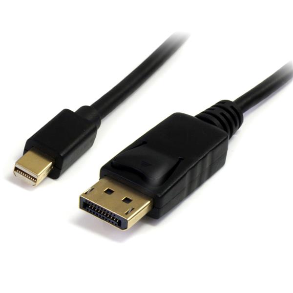

Why not DP-mDP?
6 ft Mini DisplayPort™ to DisplayPort 1.2 Adapter Cable M/M - DisplayPort 4k
