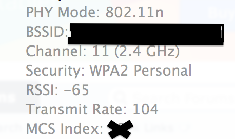

You are correct...I was mistaken. First, i am running an N connection. Spent an hour on the phone with apple care and they said theres nothing software or hardware. See below

Wired connection i am getting 44/5mbs which is better, but still not 50. When i am set up wireless i am only getting 25/5mbs

WIFI looks normal.
But if ur getting 40/50 WIRED difference, I dunno what to tell ya.

I am using 3 different internet speed test sites. Speedtest.net, Speedtest.centurylink.net, twc speed test...... Also, apple care told me to hold down "option" and click on the wireless symbol. then all that information will show up..... seems like option makes all the important info pop up.
Try turning off bluetooth. On my rMBP I found bluetooth interference at 2.4GHz is much worse compared to my previous cMBP. Testing on speedtest.net, my down/uploads were substantially lower, and variance was really high. I posted a bug report on this, and others have seen this. 😡 From your screenshot you are also at 2.4GHz...
My solution was making sure to use dual-band connecting at 5GHz with the rMBP, and now performance is consistent with my previous machine. 🙂
