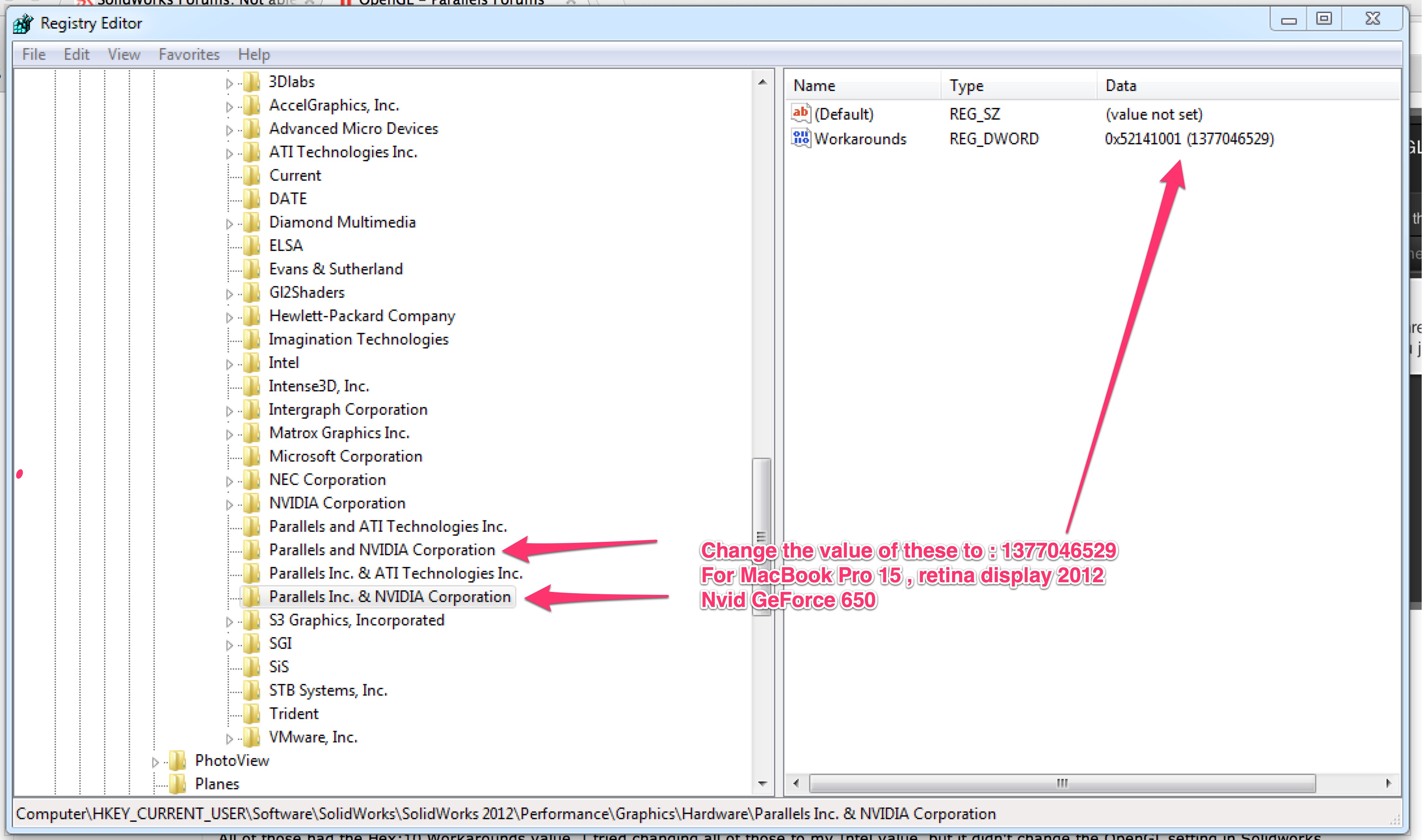

Updating registry settings to make sure it's not using OpenGL and your hardware GPU
So to make sure your MacBook Pro is NOT going into Using OpenGL mode -
use this workaround.
Open regedit, (windows button > run > regedit)
* you should never mess with regedit unless you know what you're doing , but this regedit should be harmless , either way back up your registry if you're not sure .
See the image below and go into the shown area - (see the tree location on the bottom of the jpeg.
And change the values for the two items (shown with pink arrows)

Hi- I am having the same issue. I am on a Macbook Pro Retina running Parallels 7, and Solidworks 2011.
I've made the registry edits (and have read similar fixes on other forums) but no matter what I change the value to, the 'Software OpenGL' checkbox in Solidworks stays checked and grayed out. I have Parallels set up to use 3d acceleration, so I'm out of ideas.
Any thoughts?

It is checked and greyed out ? or It is just greyed out ?
With SW 2013 it looks like you can only change that setting while you have NO models open. So open SW, and goto options - performance and see if it's unchecked.
Also , on the Mac side - there is a auto switching of video card that needs to happen - by default it should turning on , but if you want to manually turn it on - you can install a program called : http://gfx.io
