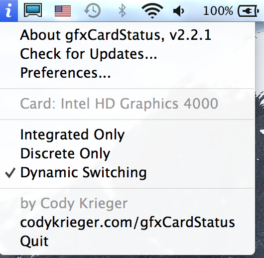

OP has Chrome running which is why the discrete GPU is kicking in. Nonetheless, here's a screenshot for you:

And just for kicks, I've uninstalled gfxcardstatus just now and as you can see the HD4000 is still activated with the AC adapter plugged in:
