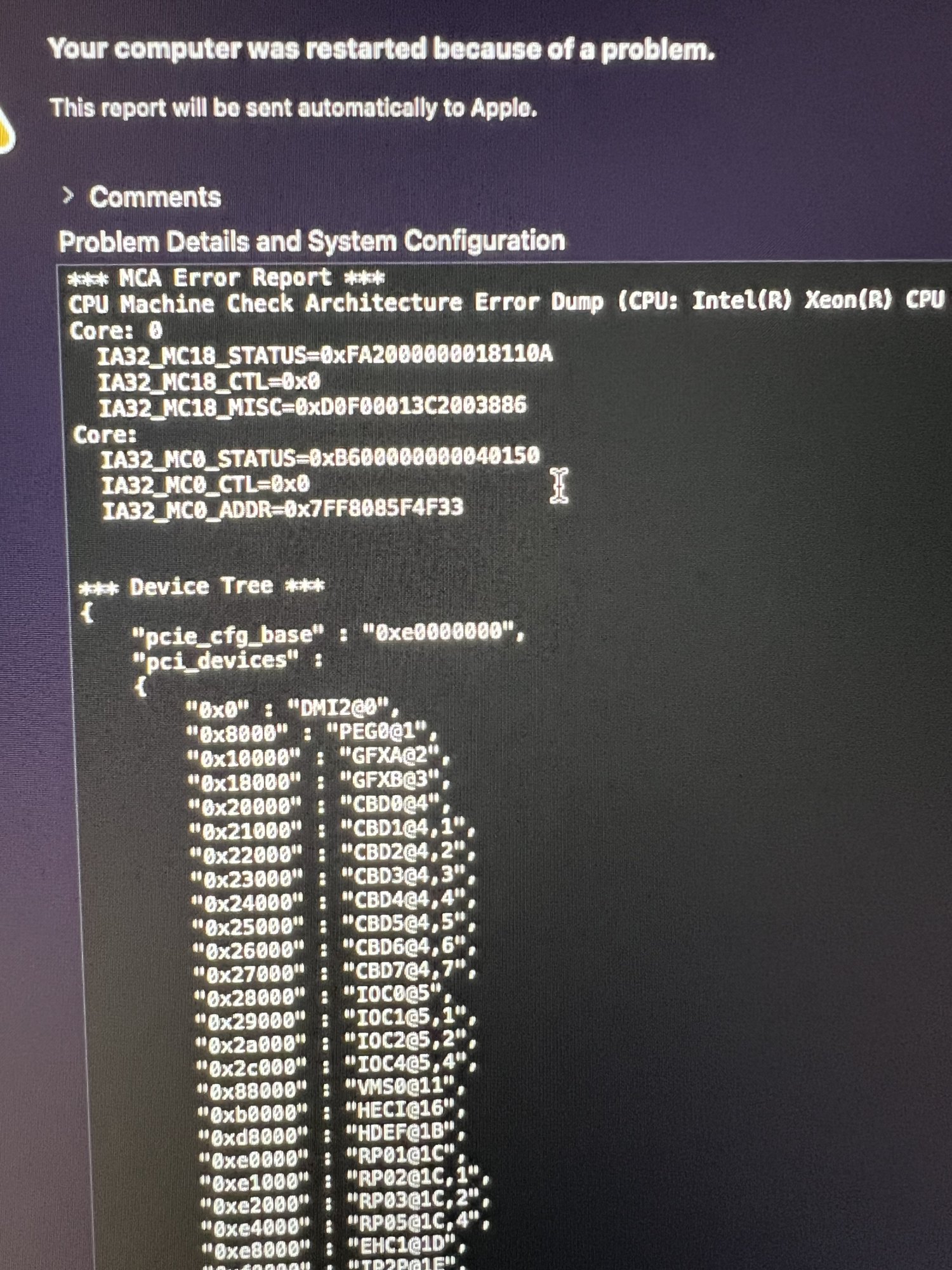

Hi Guys ,
Recently upgraded my Mac Pro 2013 and been suffering an issue where about 1 min after boot it will crash and reboot, but this will not always be the case… it also boots and works fine with no issues , but when ever it does crash , I have the MCA Architecture error I have searched for it on here but not found anything really ,
I am running the current Firmware on Montereys latest build. Any help would be great fully appreciated
Thanks all x

Unfortunately with the RAM upgrade I just did I still have the same Problem. Constant rebooting unless I’m lucky and it stays on, it’s either a faulty CPU or it’s just not liking the firmware. So looks like I’m going to go to the 12 core which is officially supported. Bummer. I needed the single core .
