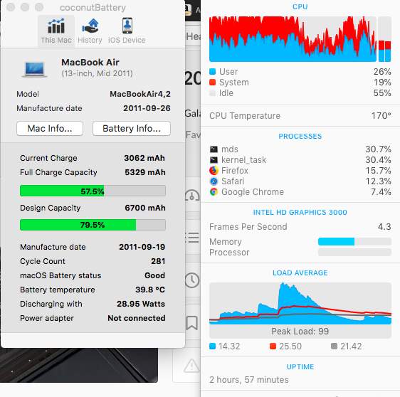

I think my laptop is definitely overheating... I hover between 170-190 temp and I'm still using the original battery from 2011.
2011 MBA i5/256/4
Thinking of getting the new heatsink, thermal paste and battery from ifixit.com
Any suggestions on where to buy these parts if not from ifixit?

I would not bother changing the heat sink unless it's defective. A replacement heatsink isn't going to be better than the OEM heat sink.
I don't believe the software. Converted to Fahrenheit, that's almost 340 degrees! I think you have a sensor problem.
2011 MBA i5/256/4
At what temperature does plastic begin to melt?
