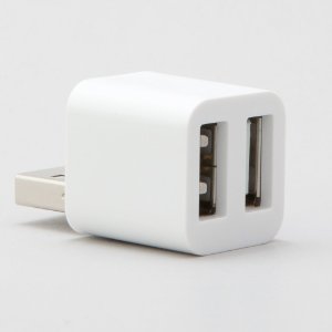

Powered can't hurt, although if the hard drive has its own power supply a passive hub would probably work fine, I really like this design:
http://amzn.com/B00A81ISJ6

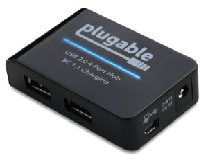

If the hard drive is bus-powered, you'll definitely want a powered hub. Plugable has always done well for me:
http://amzn.com/B005P2BY5I

3rd Gen Airport extreme being dispatched Monday, powered usb2.0 hub will be received in next few days 😀
