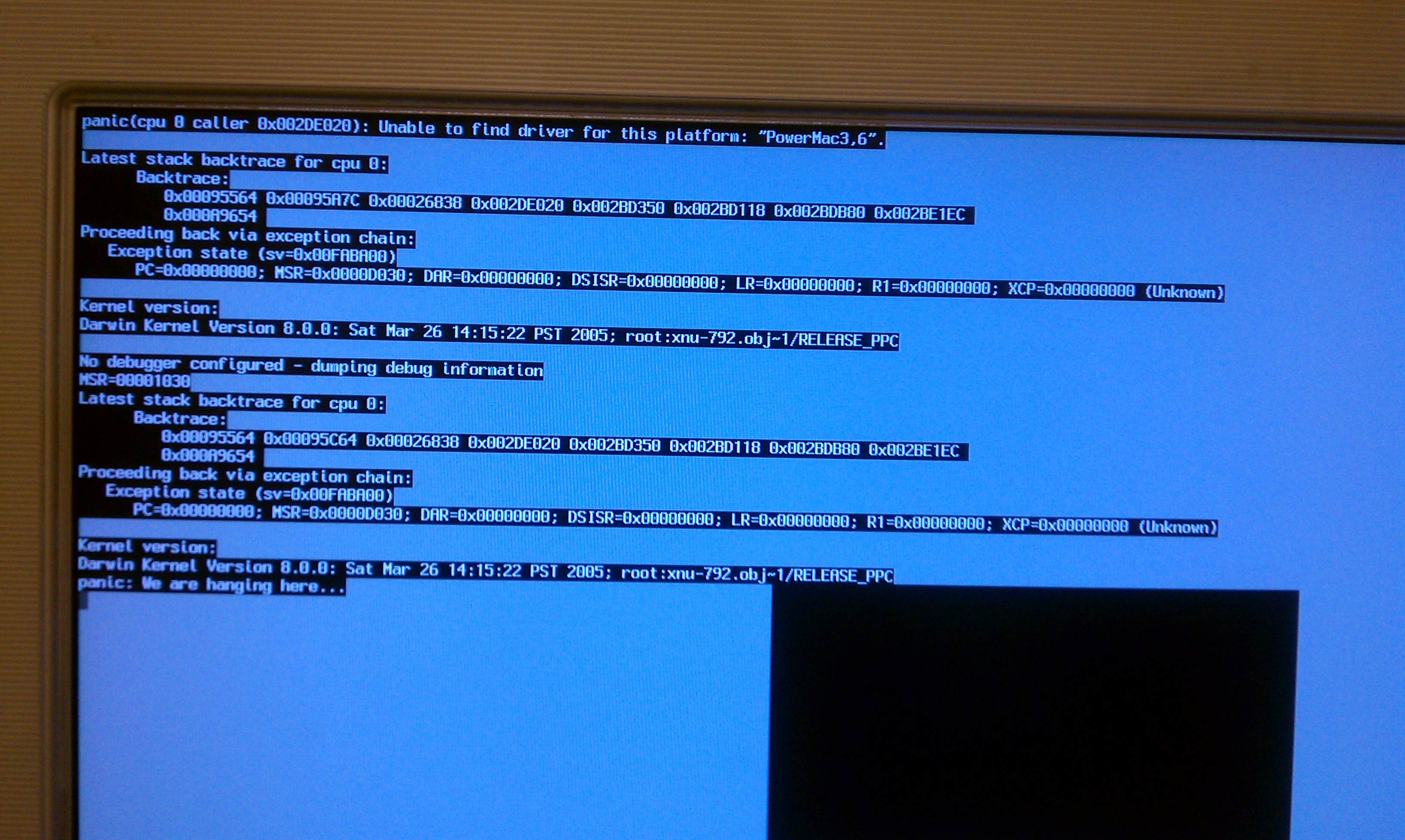

So... decided to start up my MDD 800 1.25Ghz and at first got the flashing system folder icon. So i put in a 10.5 install cd in and restarted. At first it started and i could hear the computer starting up but no picture on the screen. So i unplugged it and waited about 10 minutes. Then turned it on and after a few seconds got the startup chime and then the apple logo and the cd started to spin up and then got the following kernel panic:
I already tried replacing the motherboard and ram with no help. If you have anything i would appreciate it.
If you have done that then all I can think of is it's either the PMU or the CPU daughter card.
Are all the fans spinning properly? It could possibly be an overheating issue since it's an MDD.
CPU Daughter card? Sorry for my ignorance but is that the same as the card the has both the processors on it? I got one in the mail to replace my current one.
The fans are all spinning when i turn it on as well.
How often do i need to reapply that paste? and can it affect it that quickly after turning on the power?
