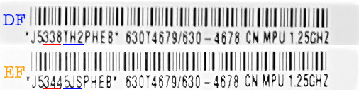

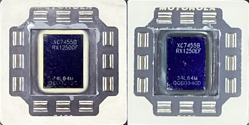

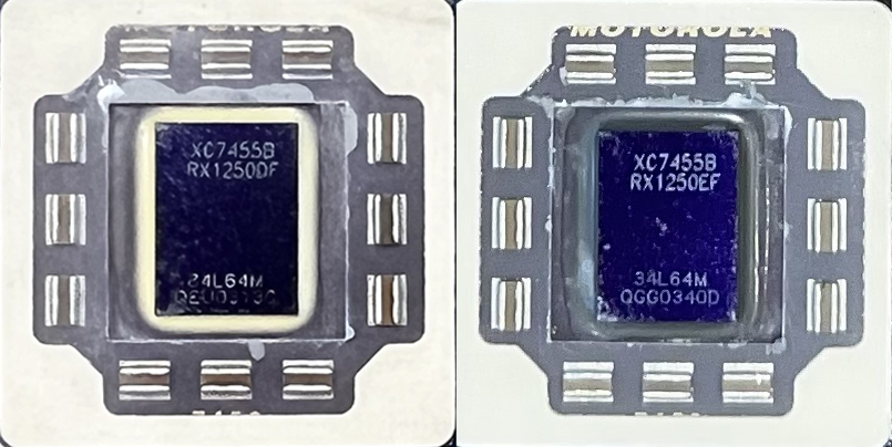

Two very similar 1.25 GHz SP MDD CPUs.
One boots OS 9 - one does not / will not.
BUT …will boot and run versions of OS X.
Any explanation(s)?
More info, this thread:
I think those are the same chip: rev "F" I can't quite read the mask number, but it looks the same.
If they both work with OS X, do they show the correct speed and L3 cache? You could also confirm that they have the same PVR in OS X. What happens if you disable the L3 cache? I would try that, and then try changing the speed or voltage slightly to see if it works that way.
