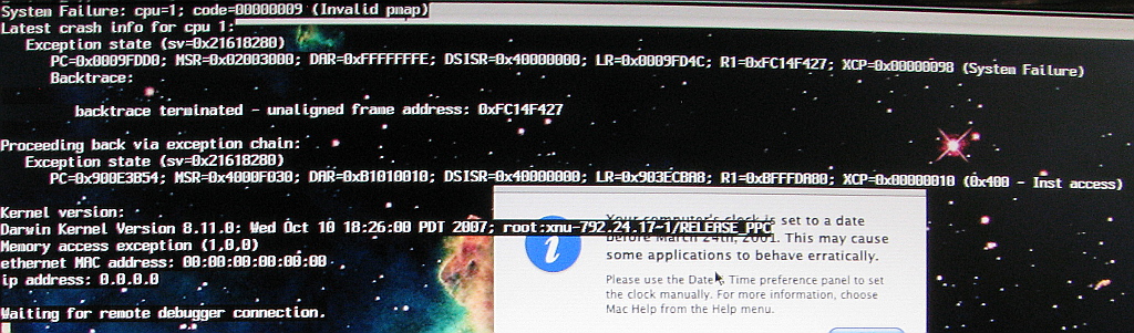

I have an MDD 1.0 DP that is experiencing lockups among other things. Here are some of the issues.
1. Anything connected to the ATA-33 bus is not detected. This includes Superdrive and hard drives. I can connect the Superdrive to the ATA-66 and it works fine. Tried different cables and such. The ATA-33 Bus does not even show up in System profiler.
2. The system locks up a different times within OS9 and OSX. Sometimes on boot up . Sometimes after using it for a while.
3. Attached is crash on screen. Other times it gets the dreaded put button to restart your mac screen.

What GPU is in it? I have an MDD like that but it was a bad logic board. Intell may be able to give a more descriptive diagnosis.
Sounds like a hardware issue. What PCI cards do you have installed other than the Rage?
Based on the top line of your KP (System Failure…cpu=1…invalid pmap) here is what I found (this person explained this fairly well I think in response to someone else's KP):
…an "invalid pmap" which is referring to the Port Mapper (PMAP) protocol which manages the allocation of transport layer ports. In short (and overly simplified but, on target, I believe), if one processor doesn't flush it's cache properly, the other processor could stumble into/over a previously used, yet presumed open frame, causing a crash. RAM not being properly cleared could also cause this.
In the early KP's in the logs posted, the unresolved kernel trap, is caused once by instruction access, and after, by data access. In the KP's resulting from data access, you have CPU 1 crashing when a deadlock occurred. A deadlock refers to a specific condition when two or more processes are each waiting for another to release a resource, or more than two processes are waiting for resources in a circular chain. This is a problem with multi-processors, and may be either hardware or software.

Then given your prior issues with the ATA bus I would say your logicboard is probably starting to fail. Usually, if there is an issue with a video card, it just fails and you get no video display. I've never heard of a video card failing slowly although I suppose it could happen.
My logicboard had this same issue, but with me it was the ATA100 bus experiences the same thing you had. You need a new logic board.
