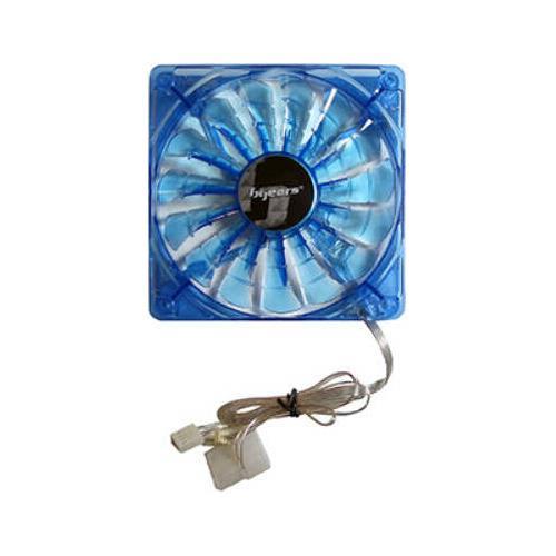

This…the bGears BG01213 (120mm) is the one I use on the bottom 110CFM.
How loud is the 110CFM running at 12V? also do they have it in red?

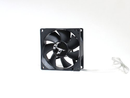

Well…It depends on you I guess. For me it's not very loud. I've also replaced the PSU fan with a Bgears b-Blaster 80mm fan which does 62cfm. So, these fans and the HD Cooler fans combined probably are louder than stock, but I wouldn't say by much.
As to if they have the 120mm fan in red, yes, they do. It comes in a few colors I believe. Different model number, though, just looked it up. Here's one from Fry's Electronics…
