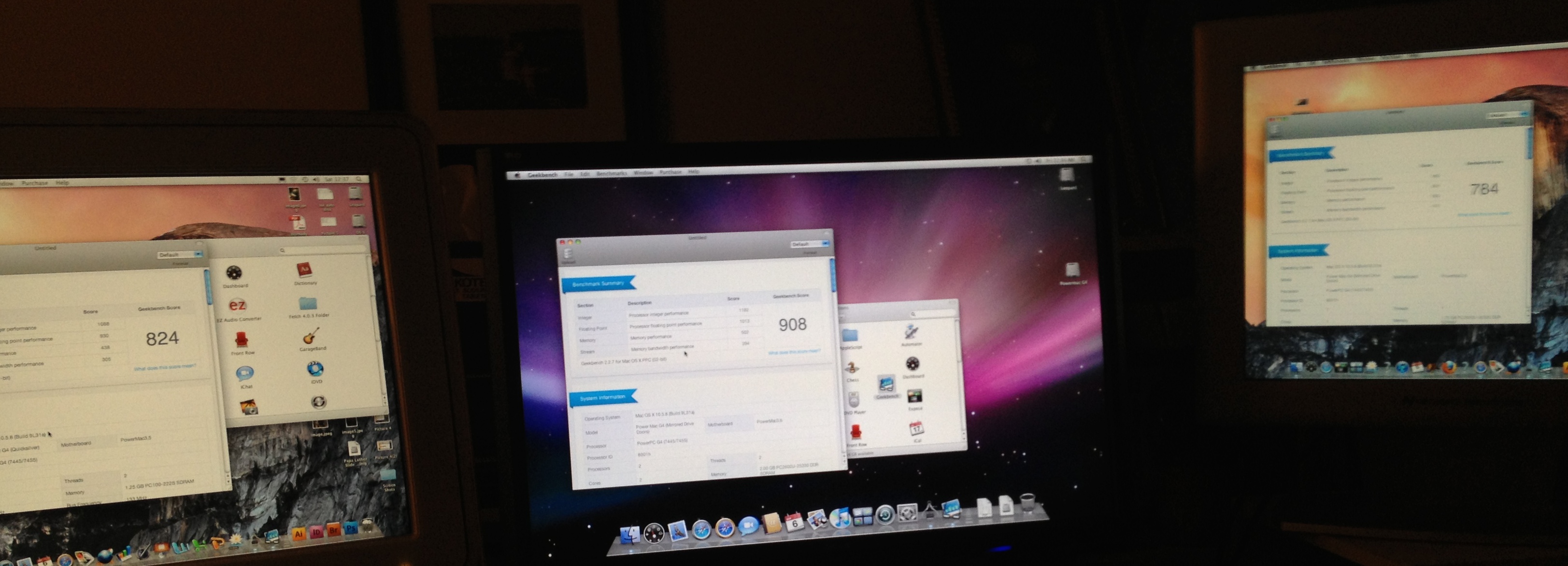

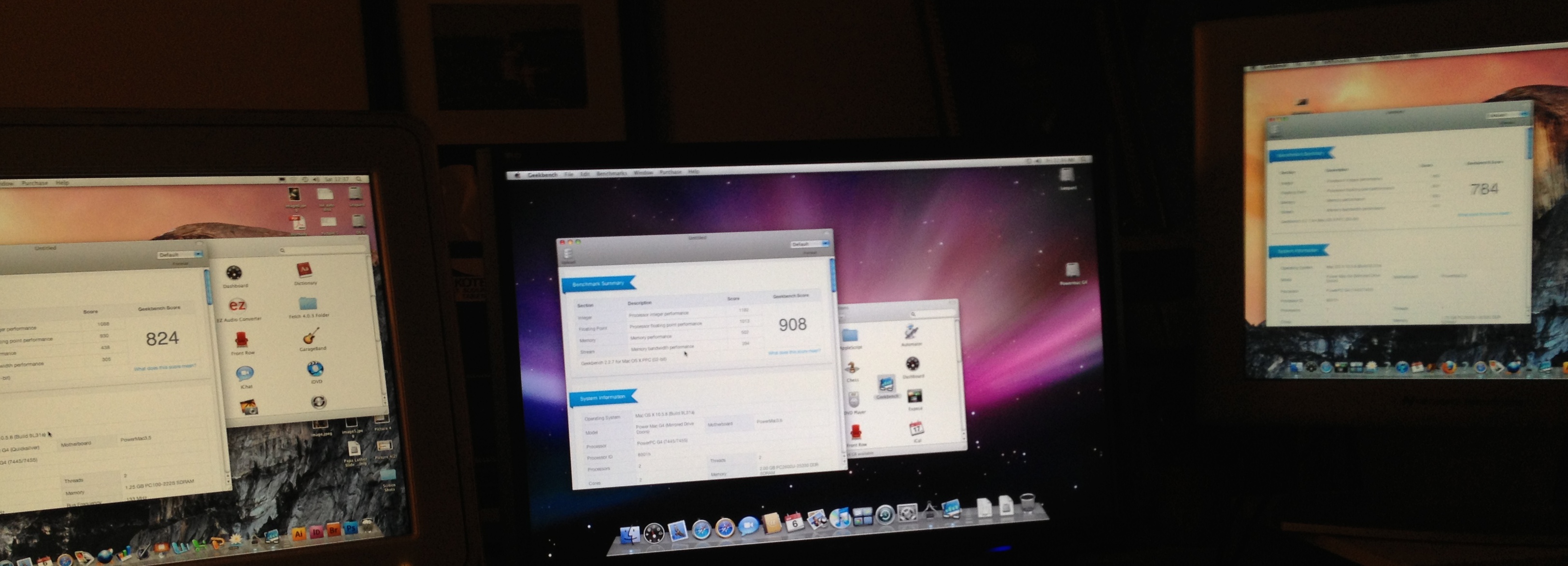

FWIW, below, from left to right, are Geekbench scores from a dual 1ghz Quicksilver, dual 1ghz MDD, and single 1.25ghz MDD. This particular Quicksilver is somewhat crippled as the L3 Cache never worked-I think its replacement(with working L3 cache) gets in the upper 800s or lower 900s-or in other words pretty similar to the dual 1ghz MDD.
