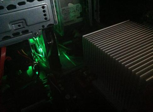

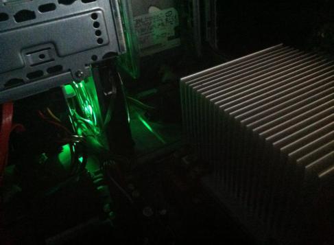

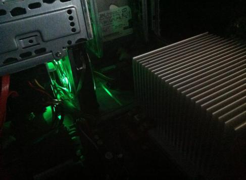

The big 120mm fan from what I've seen with both of my MDDs (dual 1GHz, dual 1GHz FW800) both stayed at one constant speed regardless of temperature. I would test the fan and replace it with a Cooler Master sickleflow 120mm fan (I put a green one in mine) and re-paste the processors. That should help with both noise and overheating.
