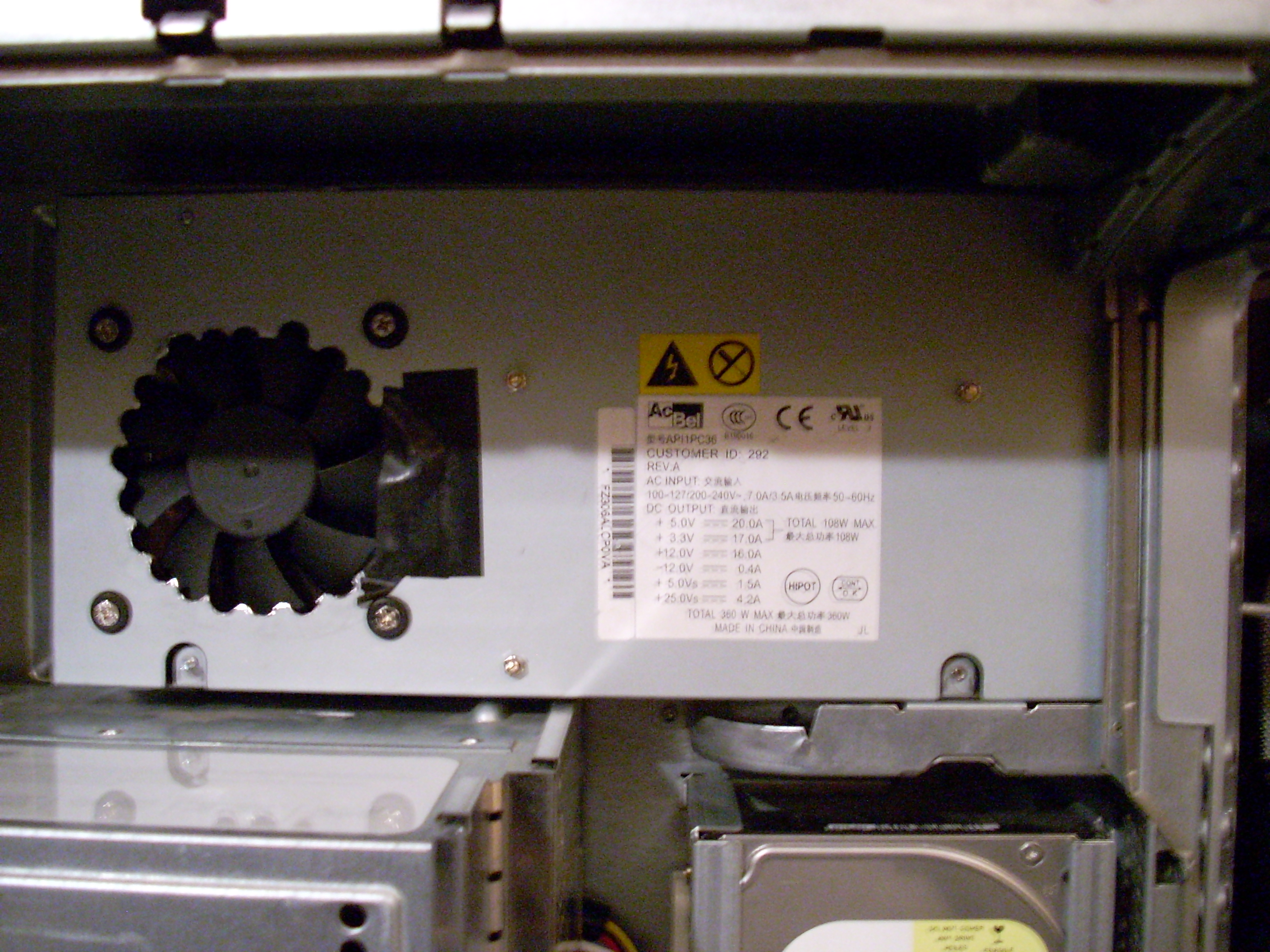

01 - Here is an end view showing the original vents taped shut with aluminum tape.

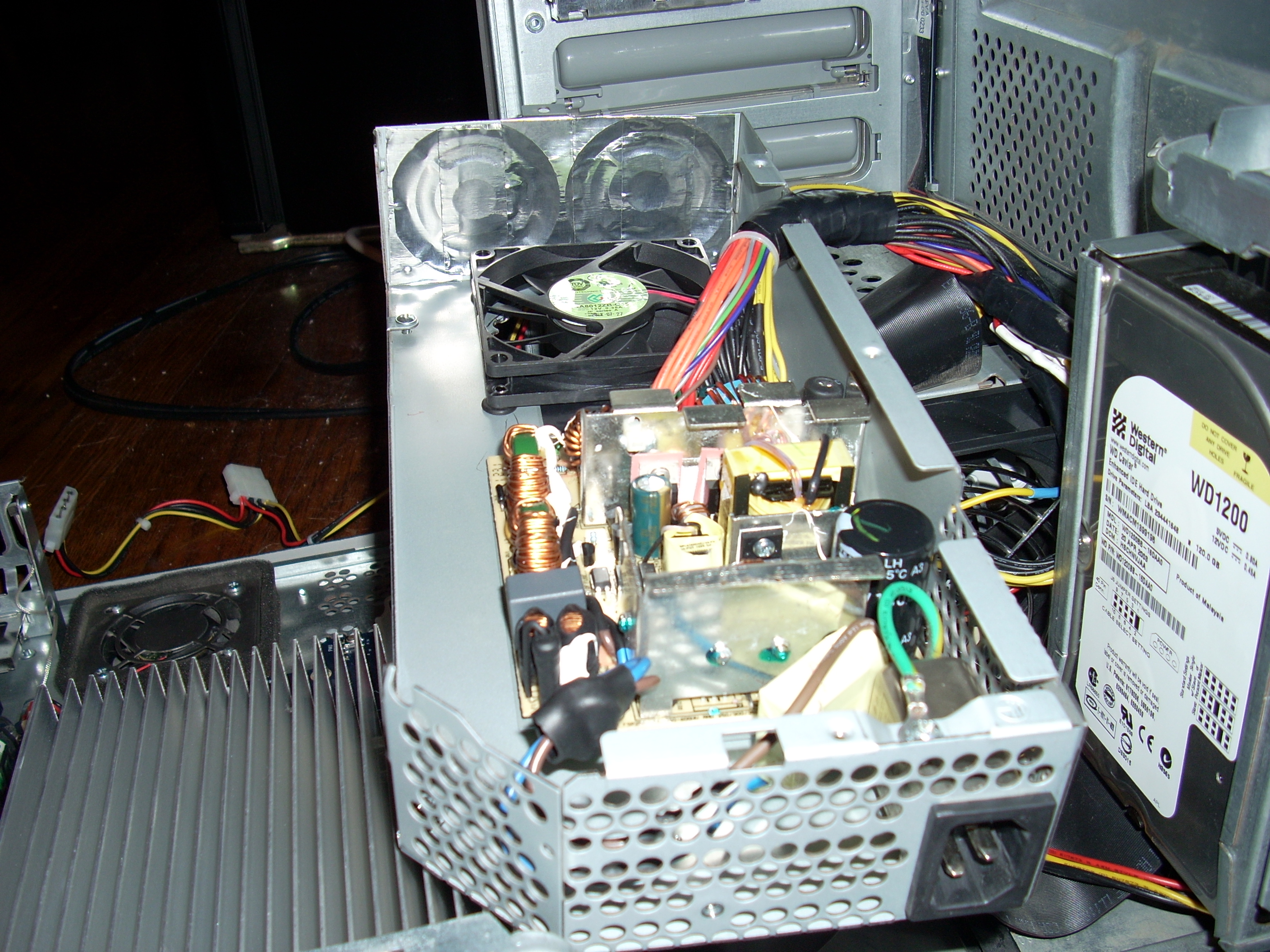

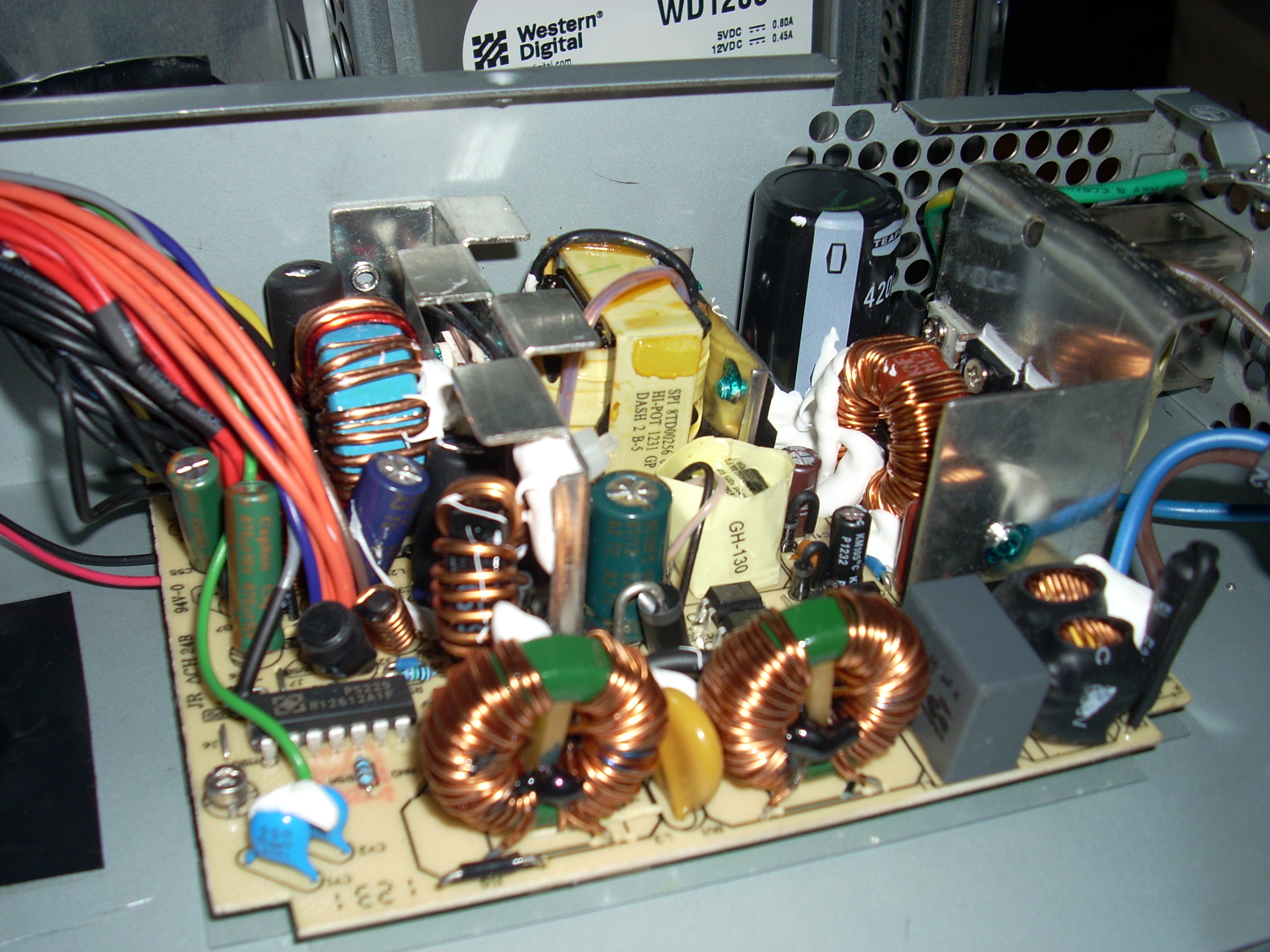

02 - Close up of power supply. Had to bend the heat sink on the right to clear the cover. If I had mounted the pcb 1/2 inch to the left, this could have been avoided.

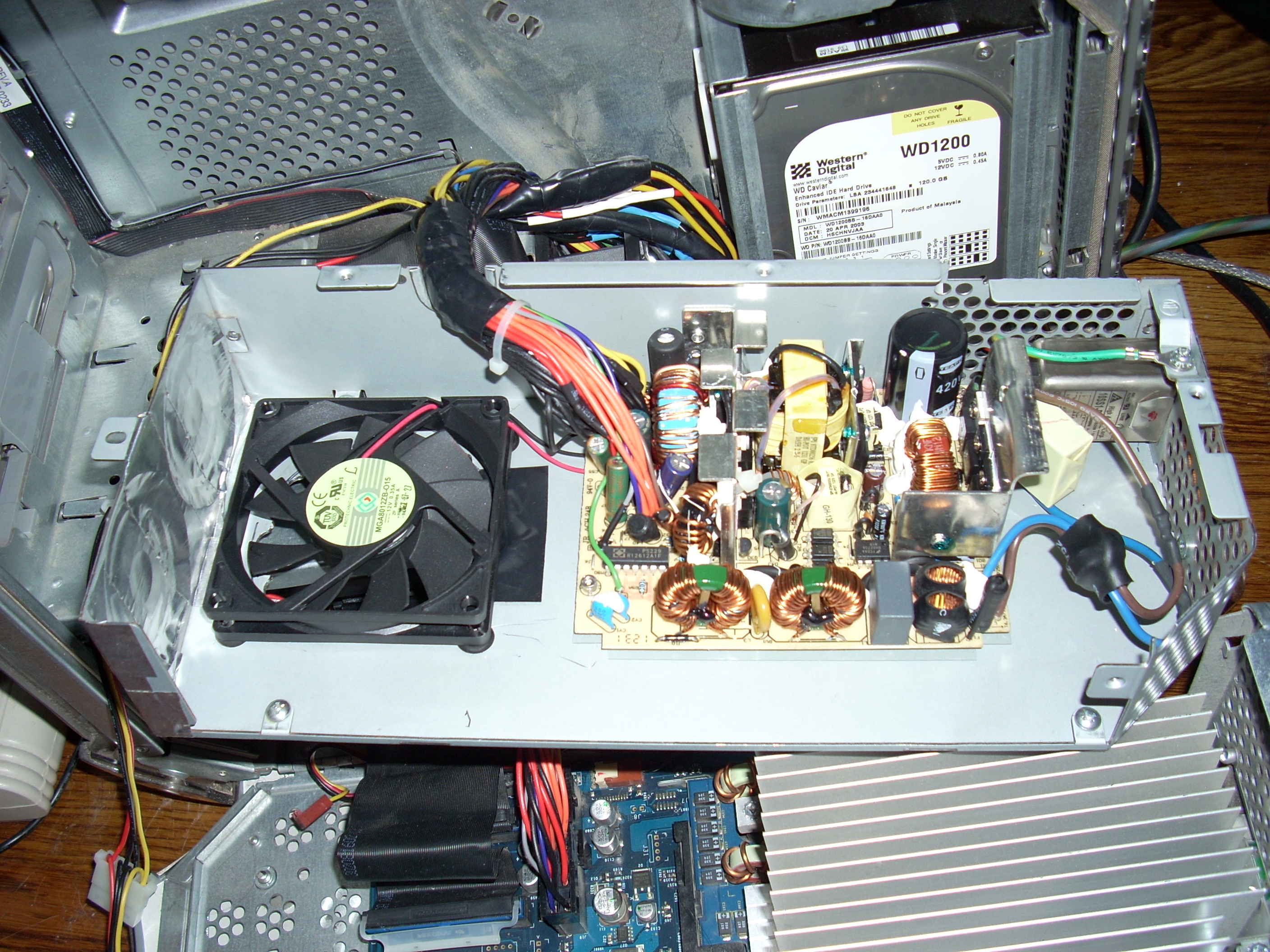

03 - Here you can see that the original power connector was used. I cut out the power switch and spliced the power supply to the connector.
04 - Mounted view showing the fan and mounting posts for the power supply. I went cheap and just drilled out a hole for the fan. Does not look good, but it works.
