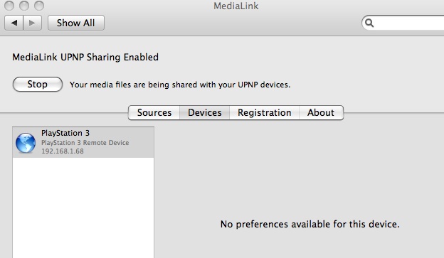

I installed Medialink and it shows the PS3 in the devices list. But the PS3 cannot see any media servers !? 😕
Is it because of some firewall issues on my 2WIRE router ? As of now the PS3 is wired to the 2WIRE router.
Seems like I'm the unlucky one 🙁
Any suggestions ?

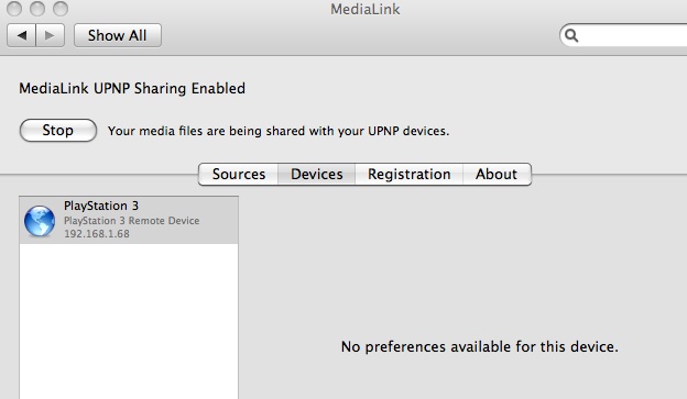

Is it because of some firewall issues on my 2WIRE router ? As of now the PS3 is wired to the 2WIRE router. Seems like I'm the unlucky one 🙁
Any suggestions ?
Try disabling the firewall. Does that work?
I tried something last night just after posting this message but Macrumors Database errors won't let me update the status. 🙁
In the previous scenario I had the PS3 wired by Ethernet to the 2WIRE gateway. The Media Server was running on wireless and could see the PS3 but the PS3 won't do the same. Then I Ethernet[ted] my MBP to the router and voila !! Prior to this I had tried opening up ports 9385 9386 (TCP/UDP) for Medialink, but that too didn't work out.
Conclusion: In my case, both the PS3 and the MBP (Media Server on it) have to be connected to the Local network by similar interfaces i.e both wired to the router or both on wireless. This is proven by the fact that I have both EyeConnect and Medialink (even Azureus) functional and running when both the PS3 and MBP are on wireless or both wired to the router. This doesn't make much sense to be since IP addresses are abstracted over the physical media and it should not be a problem whatever interface I use. After all, the application layer bothers about the IP address and not the underlying physical layer/interface. Very interesting - would be great if somebody can explain why something like this would happen.
In short - Thanks guys ! It's working now 🙂

I must add I noticed the same problem last night again. Had to wire the Mac to the router and this time the PS3 was on wireless. It worked !
I don't really understand what's the issue. Tonight I'll try disabling the firewall entirely instead of opening individual ports and see how it responds.

Must have something to do with your router, mine works fine with PS3 connected wirelessly and my iMac using ethernet. My router is a DIR-655.
