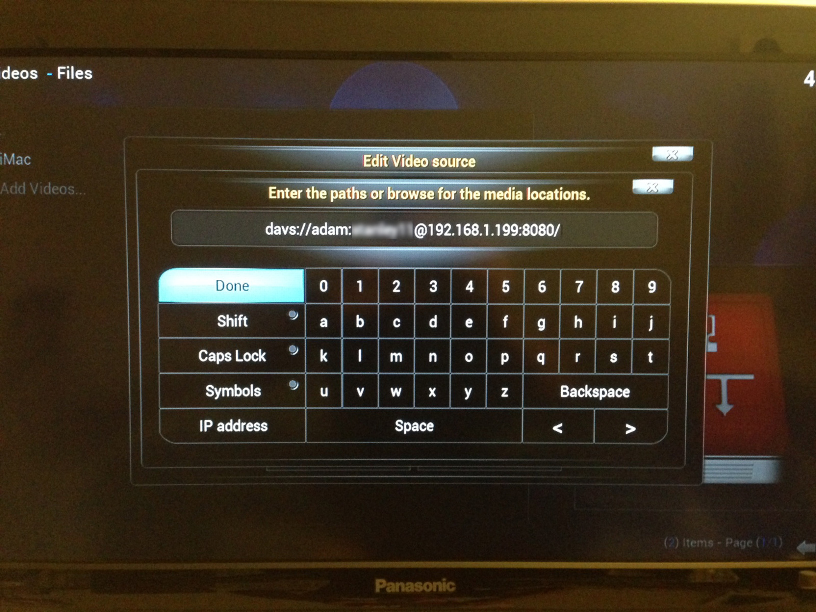

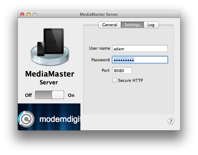

I was running 5.1 for the longest on my jailbroken Apple TV and finally had to update to I think it was 5.3. The restore and jailbreak went just fine but I cannot for the life of me get my Apple TV to connect to my shared folder using MediaMaster Server on my iMac. I have the exact same settings as before but I keep getting "Could Not Connect To Server" when I hit my iMac link in the sources in XBMC.
I have my IP address set to static on my iMac so I know it's not the IP problem. When I click Secure HTTP on MediaMaster, it doesn't even try to connect, when I uncheck it it'll try to connect for about 10 seconds and then errors out.
I've attached two screen shots of my MediaMaster server as well as the settings I have in the sources for XBMC.
Any help here would be greatly appreciated! I know it's probably something small but after 2 hours of tinkering with it and not being able to connect, here I am!
