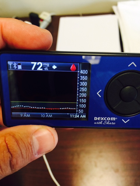

CGM's measure interstitial fluid which can lag 10-15 mins behind actual blood sugar readings from a finger prick, but the accuracy and algorithms have gotten scarily good over the past 2 years in my own experience. You insert a sensor under the skin and pop on a transmitter which speaks to the receiver that you carry (size of a pager). The sensor sends a reading every 5 minutes so you can see a trending graph of your blood sugar and the number of your last reading. See below:
Doctors who prescribe CGM will always say that they are mainly used for trending purposes. They help spot plummeting blood sugar or vice versa. They help with spotting and correcting basal rates through the day etc. I still prick my finger probably 3x a day but that is much less than upwards of 15x that I did for years and quite frankly the only reason I prick my finger now it to calibrate with my CGM or to make large dosing decisions.
