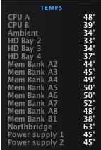

This is how iStat reports on my machine, with 4GB sticks in each slot. I think iStat needs an update for the 09 model's. It shows 8 of the 16 cores at 100% all the time. Even when I'm just writing email.

So, I have 3 ram slots filled with 1gb each and temps for only A2 and A3, is that ok?
You should get an A4 temp. 3 sticks, so you should have 3 temps. 😉
