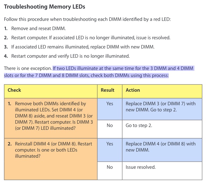

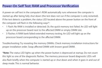

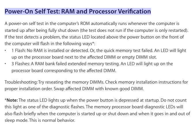

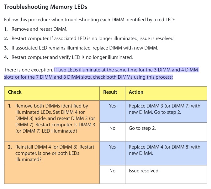

Apple states that <An illuminated, red LED indicates its associated DIMM may be poorly seated or failed.>
see screenshots for some exceptions etc. if they are of any help to you.
did you try looking for the respective macpro service manual over the web ?
I can pass my early 2009 manual to you and have a go if you like. Page 17 and further down has lot of info. i attach some screenshots for you.
