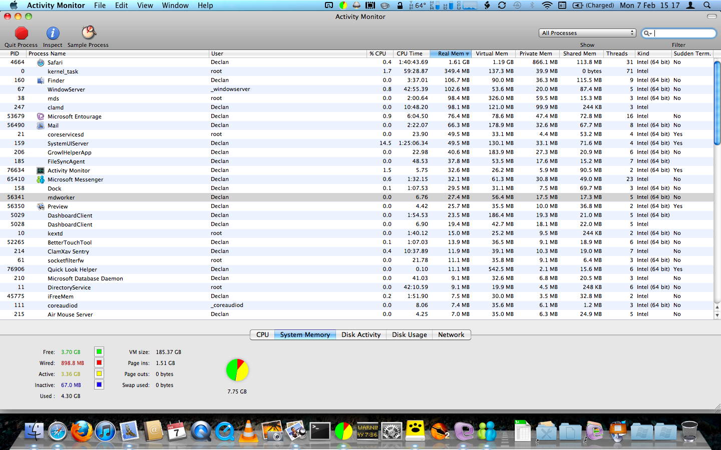

I have the same model (late 2008 2.8 ghz bto version, first unibody version). I just put 8gb in it and it's working well... originally, this model would only take up to 4gb, but I think that changed when os 10.6 came out. 8gb definitely works in mine anyway.

I know what you mean- 8gb (or even 6) isn't officially supported hence the scan results you get, but it works. I was also a little unsure, the more you read on the internet the more confusing it can get! I'm pretty sure that since 10.6 came out, this model will take 8gb (but still 'unofficially' for some reason). When it was originally released, the unofficial limit was 6gb. There's a huge thread on it here somewhere.
I'd go for the 8gb kit I put a link to, from crucial.co.uk. That's what I installed last week... it's a great price and money well spent. If you install it and have problems, you have 7 days from the date of delivery to return it.
Assuming yours is the same as mine, except for the processor speed, you should be fine!
