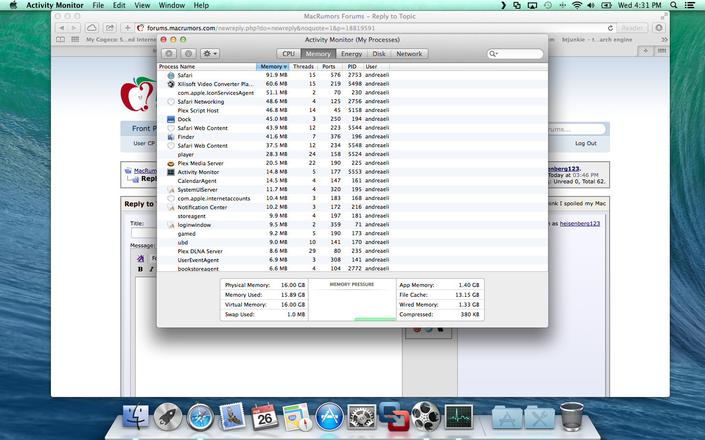

macs love RAM look at mine its used all 16GB but that doesn't mean it needed 16GB it pretty much uses more than required if its available, my MBP is not slow or does not have beach balls the RAM will just reallocate as I run more applications or tasks
