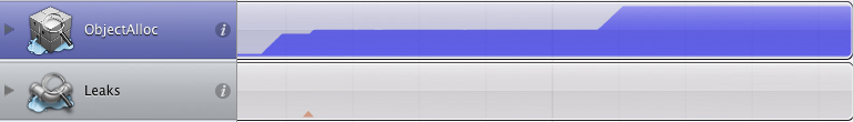

i tried this
it ran with the leaks and object alloc in play and the leaks didn't show anything on the graph when the object alloc suddenly jumped...

well... i commented out every line of code other than the call to [self createImage];
and it just dies faster now...
there must be something wrong with the way the NSImage is being retrieved...?
