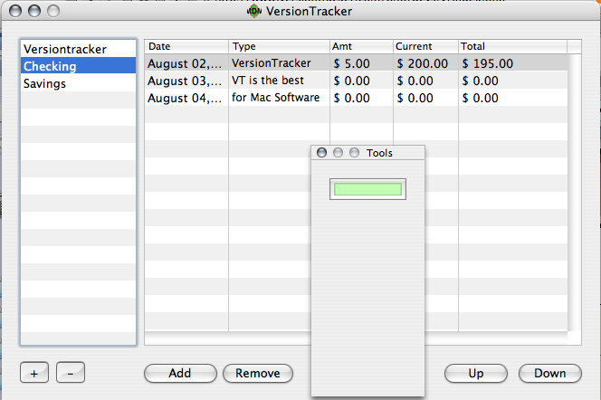

I GOT IT, I GOT IT, IT WORKS YAY!!!
Only one problem left thought 🙁
Whenever I quit the program it crashes, and it crashes when I try to set the transaction to nil. Not sure if I need to do this, but it does remove observers. Hmm.. I'm going to try remove setTransactions:nil and just release transactions, there are 0 objects in it at the end so yeah.
Screenshot!
