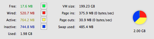

New user to here, and relatively to mac's as well, but I've been a long time lurker to these forums. I've been having memory performance problems with my macbook pro it's been doing this for awhile, reformatted my computer to see if it would fix it; fixed for a bit but turned back to being sluggish. I really don't have anything downloaded that would bog down the laptop, what it's doing is holding inactive memory from programs no longer in use, I'm aware that it's suppose to do that (from reading around) and release it to new programs thats in need of memory, it just doesn't feel its actually releasing the ram. With it not releasing the ram it's ultimately slowing my computer (I'll upload a screen shot; at the end of this) only thing I can do for it to exactly get some free memory is to purge it. I use the browser Opera a lot an unsure if thats the problem, I've read around as well and found that Opera (12.02) has had memory issues for others. I've also read what I can do to lower it's usage but that doesn't work, as I only need to open a few tabs (10-20) and its back to being slow, I feel purging it is a waste, it just gets back to racking up 750MB of inactive ram.

I read somewhere that Mountain Lion needs 2GB just to run, whether that is true or not I would still upgrade your memory, 2GB isn't that much, especially if you have that many Tabs open in a browser, I myself have 1 GB, can not install more but it get sluggish too and have a lot of pageouts.
Memory is cheap nowadays.
About whether the memory on the other computer is compatible with yours, I don't know, I would just invest a bit of money to buy some extra memory.

Well some bloated application(s) are taking 744MB of memory when they aren't even using it. Who?

No, you have to quit it manually, even then not all memory is cleared, it's the way it is.
