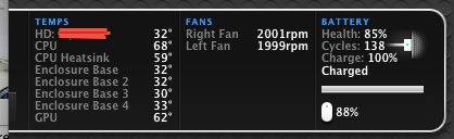

See screenshot below.
On my 15'', with light use, the only slightly warm area is the upper left corner, i.e. from the esc key down to an area near the d,e,f keys. That's more or less where the CPU is located, and the heat sinks transport that heat to the back.
Essentially I can feel the 45 C of the CPU, although the logic board sits between the CPU and the bottom plate. On the other hand I can't feel the 60 C that the memory sensor shows, although there is nothing between the memory and the bottom plate. That is why I don't trust the value that iStat shows for the memory temperature.
