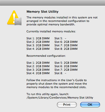

When you install new ram on a Mac (at least on a Mac Pro anyway) an application called 'Memory Utility' launches when you next boot, to either tell you that you have installed the memory correctly or that it is not installed correctly.
As far as I can see, it is supposed to go away after it's told you the ram is installed correctly.
Oh, I see.
It won't go away because you are skipping a slot, move the chip from Slot 8 to Slot 5 and it should appear once more and go away.
It is telling you that you have it set up wrong.
Thanks, but that's not my screen shot actually, just used it to illustrate what memory utility is.
It's now telling me that I have installed the ram correctly, but it's telling me that every time I boot up, and now that we have established that the memory is installed correctly, I want it to disappear.
