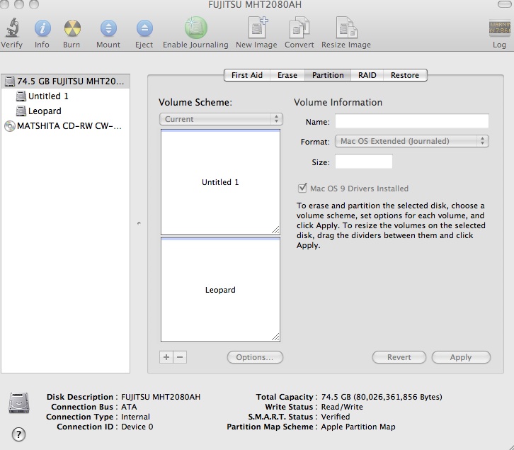

1. disk utility: won’t increase to a larger size since leopard is on the second and not the first partition — see the disk list above

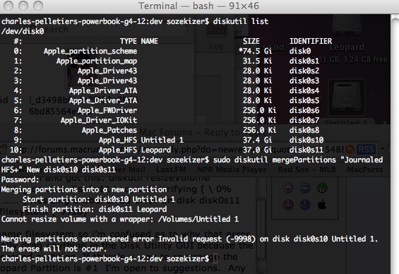

2. diskutil mergePartitions “Journaled HFS+” New disk0s10 disk0s11 Merging partitions into a new partition Start partition: disk0s10 Untitled 1 Finish partition: disk0s11 Leopard Cannot resize volume with a wrapper: /Volumes/Untitled 1 Merging partitions encountered error Invalid request (-9998) on disk disk0s10 Untitled 1. The erase will not occur.

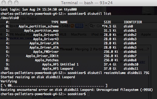

4. tried the resize function again and got this: diskutil resizeVolume disk0s11 75G Started resizing on disk disk0s11 Leopard Verifying [ \ 0%…………………………………………… ] Resizing encountered error on disk disk0s11 Leopard: Unrecognized filesystem (-9958)

both partitions are the same filesystem so i’m confused as to why that error would show. If there's a way to rearrange the partitions so that the Leopard Partition is #1 I'm open to suggestions. Any other help anyone can provide would be helpful. I'm trying to avoid having to reinstall everything.
thanks in advance for the help.

To sozekizer-
I believe the partition to be saved/used after ANY repartitioning/resizing needs to the the first partition on the disk.
Normally I would say that the answer lies in just using Carbon Copy Cloner or SuperDuper to clone your Leopard partition contents to the first partition, but I also do not think that the OS will offer you the chance to boot to a particular partition if they are both the same version of the OS. In that case, the Leopard partition needs to be cloned to another drive, be that internal or external and the machine rebooted to that. Then you can simply erase the first drive/ repartition to a single partition and then clone the information back onto it- then boot from it as if nothing had happened. 🙂
