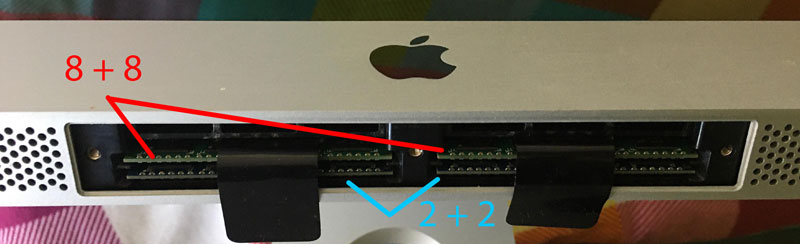

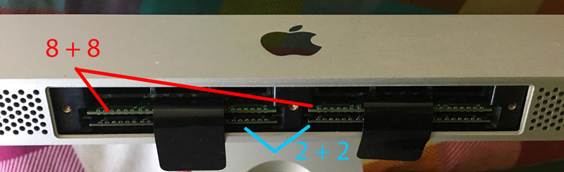

Hi, sorry for the long wait, i was away but now im back with a 16" refurbished 2021 M1 MBPro.
I did what u said and my iMac keeps on chiming endlessly with either way, Shift or T key pressed.
The old iMac...
Did you ever add RAM?
If so, do you still have the original RAM?
I'm thinking... take the 3rd party RAM out... put the factory RAM back in...
Yes I did add Ram. I added up 2x8GB summed up to a total of 20GB. In the picture u can see what i have...
You believe that its the Ram thats causing the beeping when trying to reboot? (i did have issues with the used GRFXcard i installed since September2022 though)
In which bays? In the photo, you can see where the ram is situated now. I guess the question is where should i put the original 2+2 Gb Ram?
