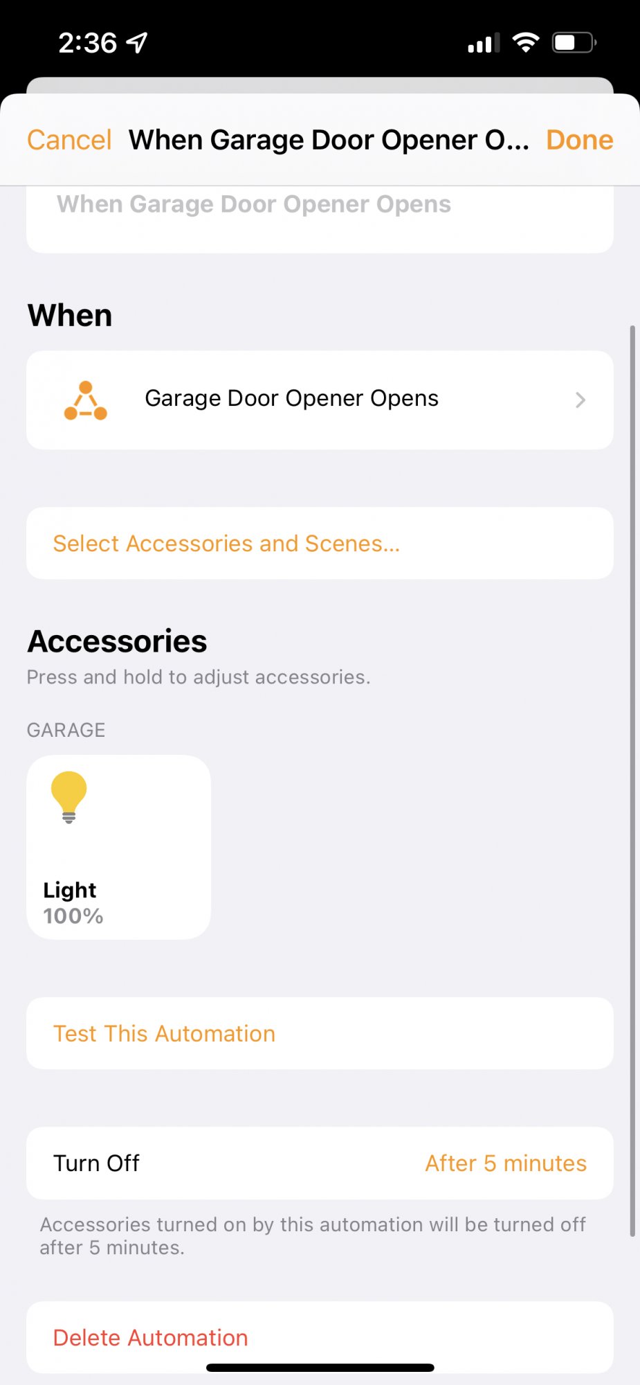

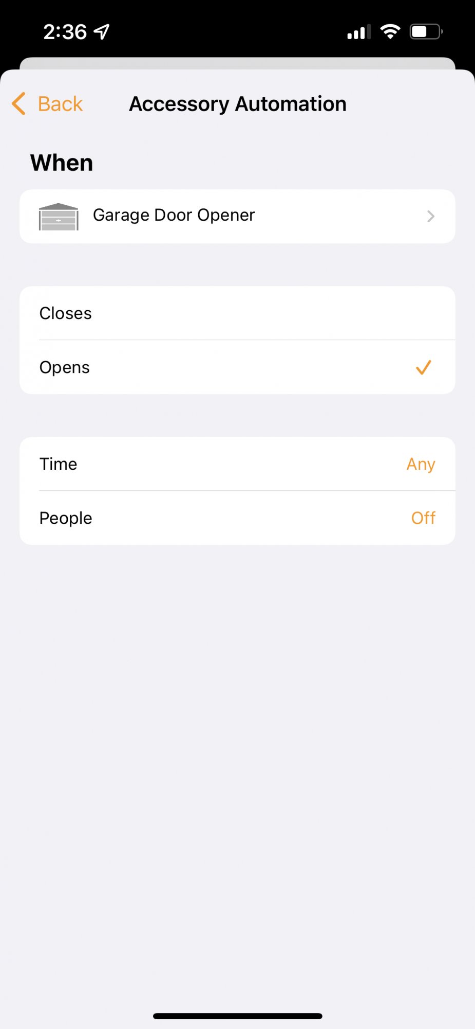

The Meross Garage Door Opener triggers my automation just fine. This is how mine is set up.
