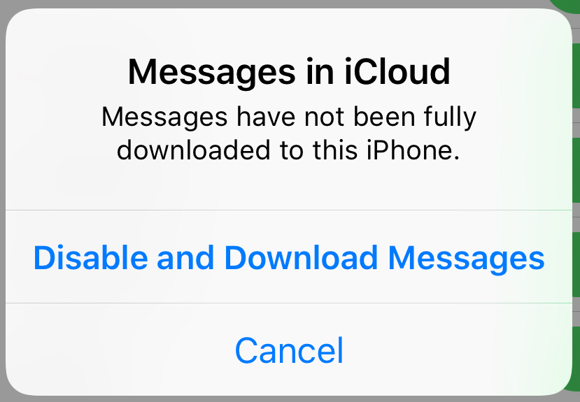

I downloaded 11.4 on both my iPhone X & iPad Pro 9.7 immediately. Straight away turning Messages in iCloud on on both devices.
They have never synced. I feel like both are stuck in some way.
I get the attached pop up when attempting to turn off and therefore have never done so.
Has anyone else seen this? Any advice?

I did disable and download, reset on each device and it works now. Didn't have many messages, none critical.

I’ve disabled on both devices.
I was hoping to restart the whole process but Apple give you 30 days to undo the disable so instead of restarting the process it just enables in the state it previously was, which is in some way stuck.
Looks like I'll be leaving off for 30 days!

Did you enable this feature on the Mac? It is not ON by default, and turning it on is not so evident. You have to open Messages, then open Preferences/Accounts and there you'll see the setting for Messages in iCloud -- you will not find it in iCloud settings on the Mac for some stupid reason.

Yes, I absolutely enabled it in the manner described. I even turned it on/off a few times. I couldn't seem to log all the way out of iCloud, but I was trying that too.

Two suggestions then:
1- Ensure that 2FA security is enabled on your account.
2- Go into your Mac's preferences in the Message app again, and on the General tab de-select "Save history when conversations are closed." (this seems to mess up iCloud Messages sync)

Wow it looks like that worked! I already had/used 2FA. But the "Save history" selection was something I was unfamiliar with. Looks like when it is selected, messages in your Mac's history are pushed back into iCloud, causing the sync problems.
I am having this same problem with mine, after about a day. In iCloud settings it says Zero KB which is clearly not true as it says I also have 14gbs of Messages. All my old messages from my Mac have still not synced to my iPhone and vice versa. When I go to turn it off I get the same popup. Tho the 'Downloading messages to/from iCloud is no longer there anymore.
Same problem for me too on ipad and iPhone X. Messages were synching perfectly until a couple days ago. Can't figure out what changed.
