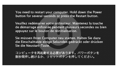

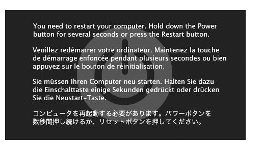

Yes I boot the computer, put cd in hold down 'c' and usualyl when it would run straight to windows xp a mac symbol comes to the screen with a little loading sign...it loads for about 2 minutes then the screen turns grey and says "you need to restart you computer" in like 5 different languages.
What as in ?
If so that's a kernel panic, have you installed any RAM lately? can you post a log?
