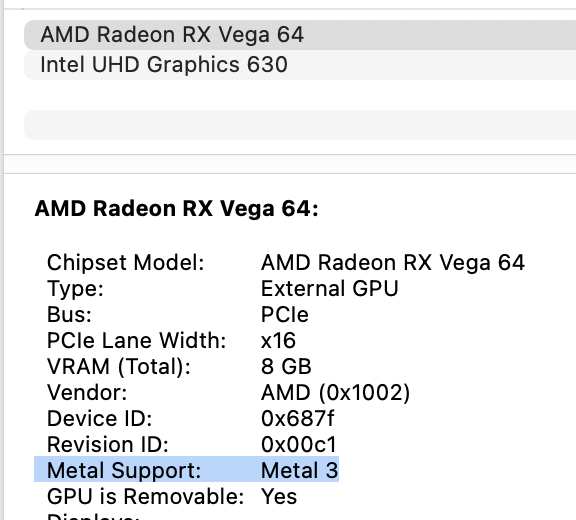

I can confirm a that bog standard 1st-gen Vega in an eGPU enclosure with a Mac Mini says it support Metal 3:
Reactions: monoton
