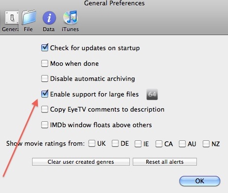

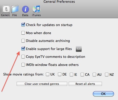

Solution!
Before you MetaX your movie, go into MetaX prefs. and check "Enable support for large files 64 bit".
This happened to me too. I'd HB a DVD and the movie looked fine, then MetaX it, and movie was corrupt (all black). I think this is caused by the upgrade to HB ver. 0.9.4.
Unfortunately, if you didn't have a backup of the movie before you MetaX'd, I think the file is toast. If you can re-rip the file in HB, and MetaX again, with the pref. checked, it should work fine.

Jacquesass and veedow, both of your solutions seemed to work great! I'm very happy about this. Not sure which one I'll use now...I'm still kind of afraid to use Metax, but I do like its IMDb browser...yet Metaz is so nice and simple...hmm. Thanks though, that solved my problem!
Enabling support for 64 bit in MetaX Preferences.

Veedow - I wanted to thank you for the tip on changing the MetaX preferences for enabling support for large files 64 bit. I had been pulling my hair out trying to work out why my videos were becoming corrupted. Your suggestion solved my problem. Thank you very much!!!
I had been using MetaX for a long time on my iMac, and I did recently upgrade to Snow Leopard. It didn't even occur to me that the problem could be related to me not checking an option in the preferences. You have saved me a lot of angst and irritation, as I am going full bore with iTunes being my central media "server" (using multiple Apple TVs around the house). I have since taken the one file I was having problems with, and have been able to successfully use MetaX with it. Great solution. Many thanks!!
