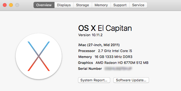

Hello,
My iMac is from 2011 I think (iMac 27-inch, Mid 2011) and now with OS X El Capistan is getting very slow. Is this normal or I need to be looking to a new iMac?.. I have 16GB in it so I guess I'm not running out on RAM. Is there something I could do to make it faster?

I've been using my iMac for the same thing since I got it.. Graphic Art work.
The HDD is 999.35 GB and it has 825.77 GB of free space
