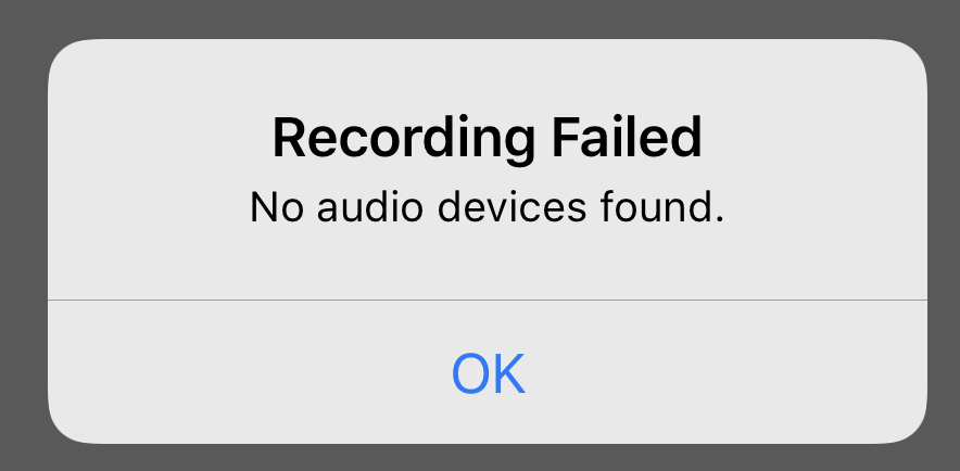

Hey folks,
I'm wondering if anyone else is suddenly having a problem with the microphone not working on their iPhones, 7+ as I have or otherwise. I first noticed it a week or two ago, when trying to post an instagram story. The phones mic does not work, the corded mic does not work, but when I'm on my bluetooth headset or in my car (connected via bluetooth) it transmits audio just fine.
The speaker still works. When I attempt to place calls while NOT connected to bluetooth, it disconnects immediately.
I have spoken to two other people that are experiencing the exact same problem although in either case I did not obtain the model number of their iPhone's.
I first thought it was a hardware failure, from a drop or some such, but I'm leaning now towards software but I can't find solutions online anywhere. All of the tutorials on fixing this do not work. I've done the resets etc. I test this by trying to use the voice memo app and receive the following error (see attached file upload).
Just thought I'd come in here and see if anyone else is having this problem.
Thank you,
Kyle

Kyle, I'm experiencing exactly the same problem! And besides that: If I plug in my earphones, they're not working, the music plays as if no earphones are connected. Charging no problem though. Thought I maybe dropped my iPhone 7, but I read on some forums that it's a problem on many more iPhone 7's. Must be software then? Since I don't see any other replies, did you hear of any solutions yet?
I've heard from another friend now with the exact same problem, we couldn't have all just collectively dropped our phones. Like you, my plug in headphones do not work, however as previously mentioned, any sort of bluetooth device and it's fine (sony headphones, my car). I have no heard of any solutions.

It could be a software/firmware issue but if resetting and restoring the device doesn't help, then you clearly have a hardware issue.
The iPhone 7 series of devices have proven to be very unreliable, suffering from flex-based issues similar to the iPhone 6 Plus (Touch Disease). On the iPhone 7, the fault line runs along the top of the SIM card reader and affects the Baseband CPU and Audio IC. Any short copper traces running perpendicular to the fault line while connecting to micro-BGA pads, is subject to failing.
On the Audio IC, this particularly affects the C12 pad/trace although there are 4 pads/traces along the fault line. Of those four, the C12 pad (I2S_AP_TO_CODEC_MCLK) is the most critical as it is a communication protocol line between the CPU and the Audio IC.
Here are the typical symptoms, as collated by the repair community:
# Voice Memos app / Loudspeaker on call - greyed out
# Siri doesn’t hear you / Caller can’t hear you
# Most other Audio related issues that aren’t solved by modular replacements
# Long boot times (3-5 minutes)
# iTunes detects the phone but stuck on the Apple Logo
This is a repairable problem but it requires a micro-soldering repair.

The long boot time is a dead giveaway. The iPhone 7 is a high value device and this repair is not that expensive. Having it repaired will keep it out fo the landfill and allow you to use it or sell it to someone who will appreciate it.
