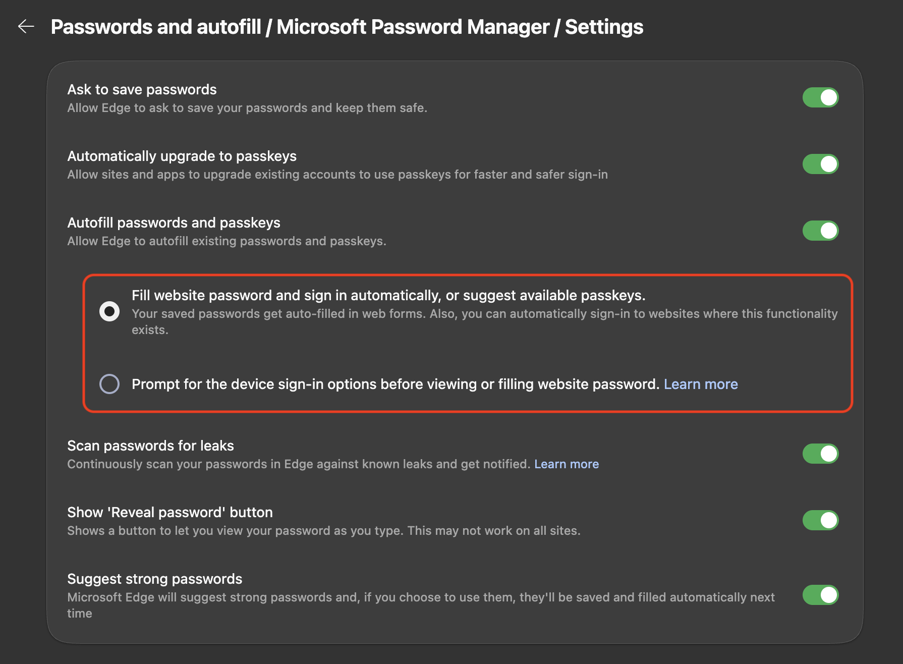

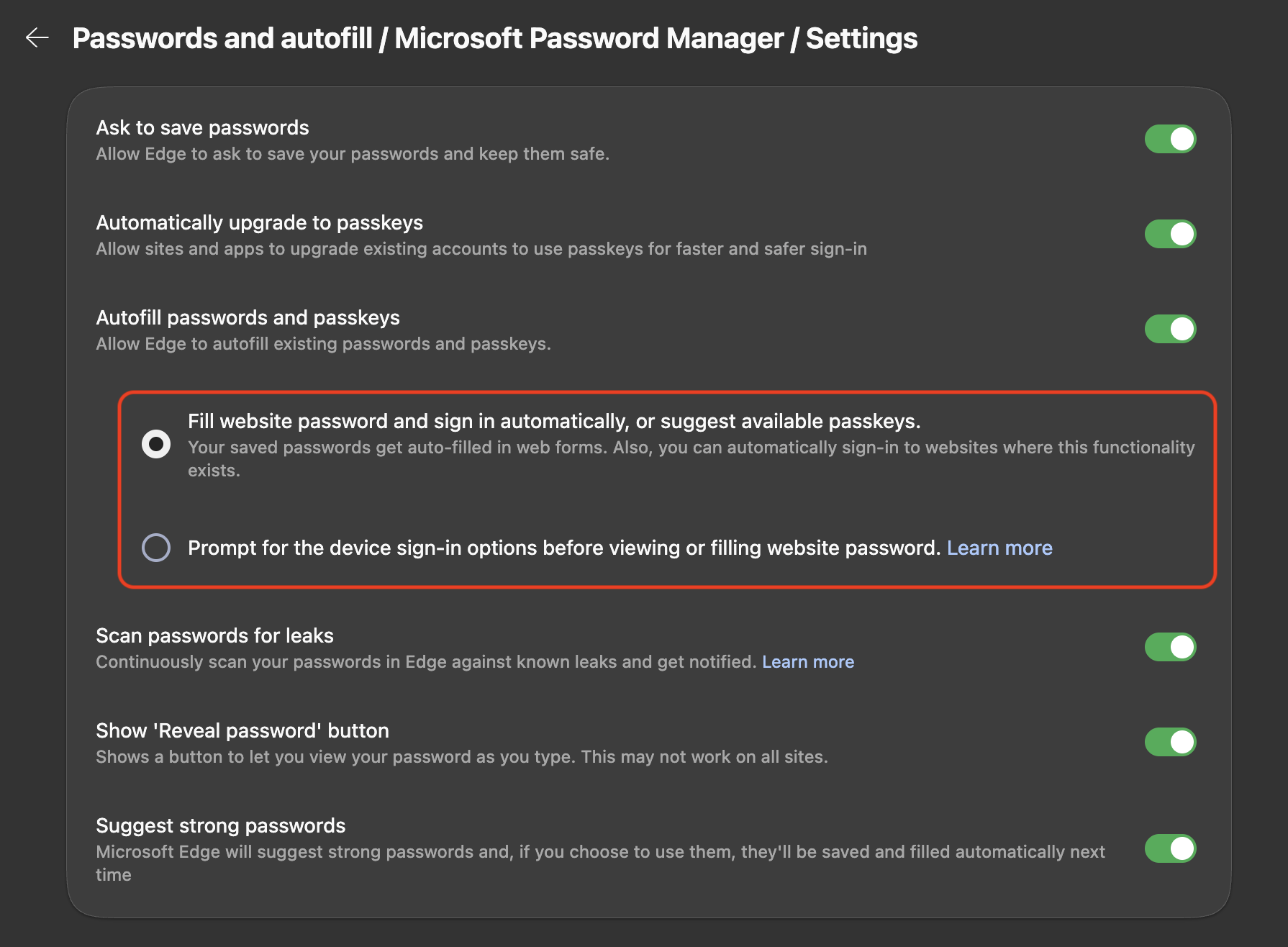

Were you using a Custom Primary Password before (your own "master" password)? Microsoft phased that out and switched those users to use device-based authentication instead (your Mac user password or Touch ID). If you weren't using this before, then your settings must have gotten changed accidentally.
In either case, you can go into your settings within Edge and change it to not require the device sign-in.
I don't think the user had a password set initially. Toggling that on and off did NOT help. Note that this is only impacting one of 2 machines that the customer logs into with their M365 account at this point.
