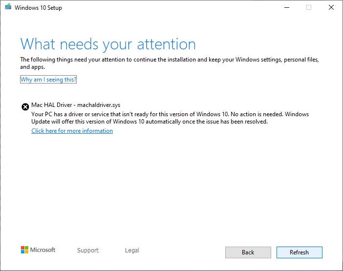

Microsoft is facing an issue with Windows 10 updates for Mac devices that came out prior to 2012, as well as newer Macs with older versions of Boot Camp. When users attempt to update to the May 2019 Feature Update for Windows 10, version 1903, there is a driver incompatibility error.

2 months late (MAR -> MAY) not 4. Thankfully, the update to 1903 does make some important checks before borking someone's system because they have an incompatibility with a driver, etc. Since 1809 didn't fail with the same hardware, I'm guessing there are other changes to 1903 that require more scrutinization of drivers and devices.

Actually you can't, even with an offline install. The problem isn't with the update saying "You're ready" the problem occurs once the update is initiated. There is a point in the 1903 install where it checks your system for compatibility and it fails. This one at least tells you "why" it fails. There are many systems out there running windows that fail the install for 1903 and don't even give a specific reason.
