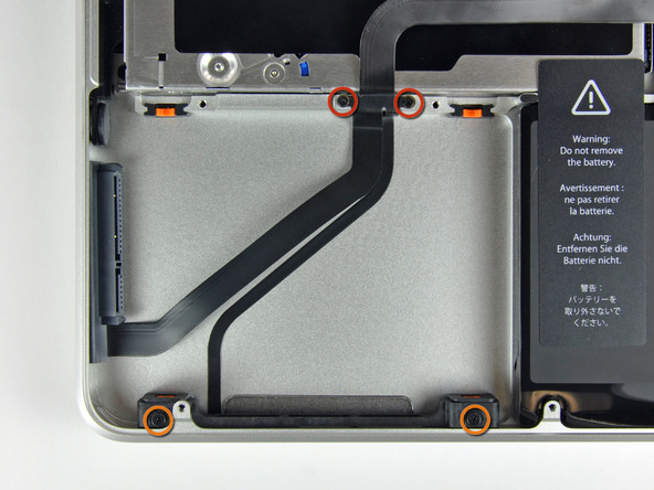

I picked up the new cable, and I was just following the iFixit guide.
mlI3OqOY6dZTUEIw.medium
See the 1.5 mm Phillips in the leftmost red circle?
Mine got stripped while I was trying to remove it. I wound up pulling the rest of the cable out and leaving the screw there for the time being before putting the cover back on. It's running OK without it, but I still can't put the new one in, yet.
What now?
I ignored the screw and put the new one over it while fastening the other one in. It's working just as well.
