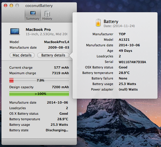

And this is CoconutBattery:
Those could be the source of your problems. Try replacing them with Apple OEM parts. MagSafe and batteries should never be replaced with third party products.
