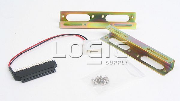

The adapter looked like this, I'm in Toronto so what's available here...
The sensor on mine was two wire, a little wire jumper did the trick. SSDs don't get very warm so heat isn't a problem. I put a 180GB OCZ Vertex 2 in the iMac and it's nice and fast. I archive my files on a NAS.
