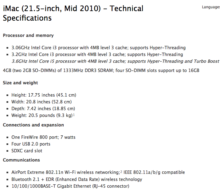

Hi, can anyone help. My Mac made a series of loud beeps then turned off. Now every time I turn it on I hear this fast clicking sound like a dialling on an old phone? The screen stays white. Cannot boot up the system. the clicking becomes intermittent. I have tried booting into recovery mode. Cannot get access to anything.I bought the machine used about three years ago. I don't have the original disc. It had 6 GB of memory. I have wiped it out a few times with no problems. I had Osx El Capitan installed and had no problems with it. I went on Apple site from another machine and got the original specs. I have supplied a pic. Any advice would be appreciated. shot 1.png
