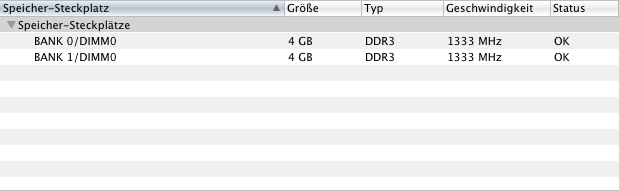

Hi,
I just threw 8GB of 1333MHz DDR3 into my Mac Mini (2,66GHz). It seems to recognize it correctly as 1333MHz, but I guess the bus speed of 1066MHz limits it anyway.
If the RAM would run on 1066MHz, it should show up on System Profiler, shouldn't it?
http://browser.primatelabs.com/geekbench2/view/265076
It don't know whether this is known yet, or brings any advantage because of the bus speed.
Things are blazing fast compared to 2x1GB 1066MHz, just for the record 🙂 It should come with 2x2GB as default, as the cost for DDR3 reduced in the past anyway. 2GB is just insufficient, even for minor simultaneous daily tasks.
Regards
Edit: According to Geekbench they are as fast as the original ones. Maybe 1066MHz 7-7-7-20 are even faster, because these are 1333MHz 9-9-9-24 and there is no faster timing available.

Hi,
