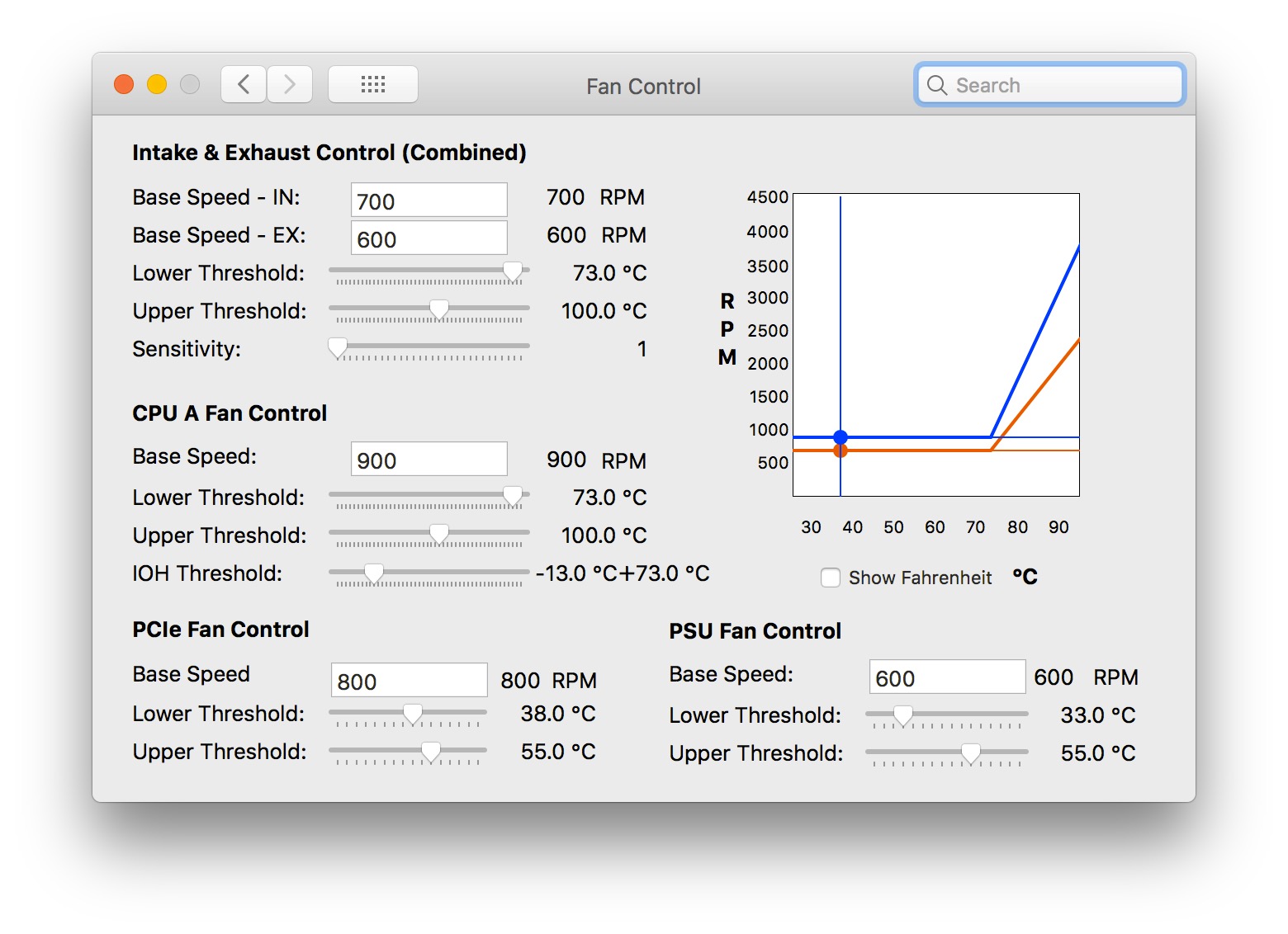

I have roughly the same intake and exhaust fan setting to avoid that beat frequency. It works very well.
Anyway, I suggest you use SMCFanControl but not MacsFanControl for this kind of fan control.
SMCFanControl increase the intake fan speed by altering the minimum RPM. It tell the SMC that the intake fan minimum RPM is now 700, therefore, the fan will spin up to 700 (if it's below 700). And if your CPU is really running hot, the SMC call ask the fan to spin up further, because the minimum fan speed won't stop the fan to spin faster.
However, MacsFanControl is controlling the fan by assigning a target RPM. It tell the SMC that the intake fan target RPM is now 700, therefore, the fan will spin up (or down) to 700 RPM. If your CPU is overheating, the intake fan will still only spin at 700, because that's the target RPM. It override all other parameter.
Thanks for the advice! I was looking for a way to alter only minimum drive. I tried smcFanControl earlier but it didn’t work. Moved it to the applications folder -> working!
But what’s that Prefpane you are using? This does not look like smcFanControl.
It's an open source Fan Control software, I modify it to fit my own usage. I never post the one that I am now using, because it require assistant from smcfancontrol. A bit too complicated on the initial setup, so I keep it for myself. But there is a thread in this forum for this particular software, and there are few other versions available at there.
https://forums.macrumors.com/thread...ol-now-version-2.1340705/page-6#post-24547028
What I want is both PSU and PCie fans are controlled by setting target RPM. Because there is a SMC bug in the 2009 mode which may cause high PCIe and PSU fan until stress the GPU after each boot. This is annoying, and cannot be fixed by altering the minimum fan speed.
On the other hand, I want all other fans are controlled by only altering the minimum fan speed, so that I don't need to worry about CPU overheat.
Besides, I want to control BOTH the minimum fan speed, AND the spin up temperature threshold.
Furthermore, I want the CPU Booster fan will spin up automatically if the Northbridge is getting warm. (this single fan will spin up either the CPU or Northbridge temperature reach the threshold)
Last but not least, I want to minimise the CPU usage (MacsFanControl actually use about 10x more CPU than this software. Even though we are just talking about 3-5% CPU usage, but I personally don't like it)
Since there is no software can fulfil all these requirement. So I decided to modify one for myself.
