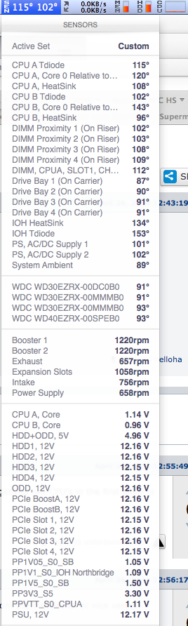

I've been running this setup since January without any problems then suddenly I started getting the spinning ball & lock-ups. Installed iStat to monitor the temps and found I was way out of the limits of these CPU's. Any ideas? I've attached the screen shot of the iStat readings.

I am quite confident that the reading is in Fahrenheit. In this case, the temperature looks good to me. And the fan speed is also normal.

That screen shot you posted shows that you were 120F and 143F from ProcHot. That is nowhere near overheating (quite cool actually) and is likely hour CPU temp when not under any stress.
The X5650s should not get within 10C of their Specified Upper limit (96C core temp). At least, that is my experience with that CPU. Handbrake and Prime95 could only bring it to 10C below ProcHot when the room temperature was 80F.

I assumed the default was C but, I was wrong...
Since most CPU specifications state Celsius, I just assumed iStat defaulted to C. Glad I haven't cooked anything... I use the computer to manage my media and streaming throughout the house is daily (apple TV, airport express speakers, etc).
