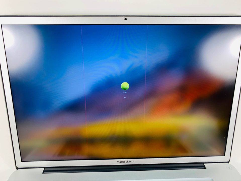

Hello,
I'm pretty new to the forum and definitely no tech here.. I see a mid 2010 17" Macbook pro on my local market place and it's got two red lines running down the screen.. They want $450.. Is this an issue that can be fixed easy? I would have to take it to a repair shop obviously.. And would probably try and get them down on the price if it's worth it..
Thanks

These are prone to GPU failures. Avoid 2010-2011 15 and 17 inch models altogether. Even $450 is far too much for any of these.

You're buying an 11-year-old laptop for $450... that's not a good deal at all. And it has vertical lines on the screen which could mean anything. If you really need a large screen you might be better off getting a later 13-15" MBP and a portable external screen.

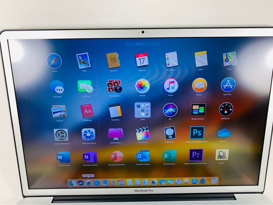

Now, regarding your question, these lines on the screen looks more like a screen/display failure than a gpu failure. Even on the 2011 with the known dGPU problem if you use dosdude1 method then you can fix them. But from what i see on your pictures it’s nothing like that, so possibly it cannot be fixed.
second hand 17”s from 2010 cost around 400 with flawless screens. With these lines on the screen the machine loses around 150-200 of its value

If you could get one in mint condition with only slight use, you could consider it, but I really doubt there are many good units left out there. 11 years are 11 years no matter who had the unit. No matter how nice the unit is, I would never ever get a unit with those red lines. This means the gpu is about to die, so you will need a new motherboard for that one Which will cost another 350 bucks at least.
