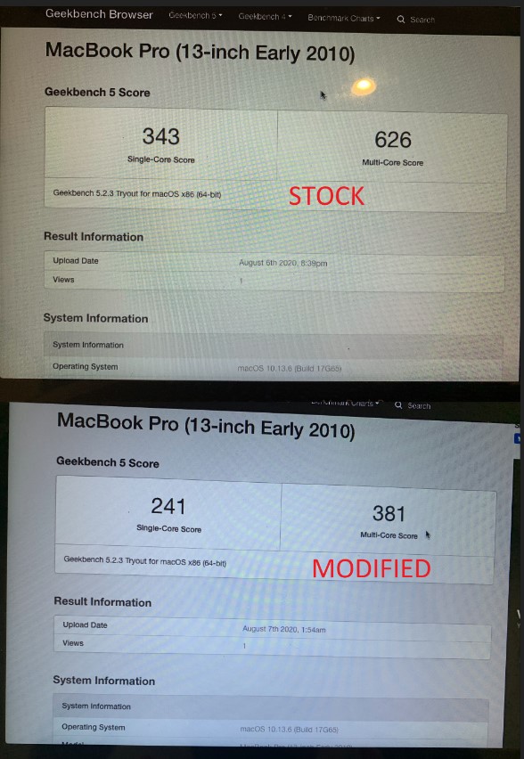

While the machine seems to boot up faster, all the post-upgrade tests I ran have lower scores that the pre-upgrade benchmark tests, except the Blackmagic test scores with about tripled.
How is this possible and did I do something wrong? I have a series of test if you scroll down. Is it possible the old Intel Core 2 Duo is limiting the performance of my 16GB RAM?
Original Geekbench score vs the 16GB Upgrade

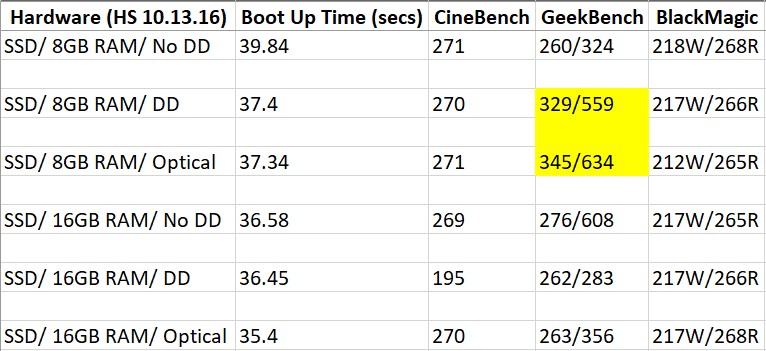

My latest tests as of 8/11/20. Troubleshooting numbers. The SSD is constant. DD is 250GB HDD Data Doubler installed. No DD means it was just unplugged but in the machine. Optical means I installed the optical drive back. What is curious to me is that the 8GB RAM with the DD and Optical out performed the 16GB RAM on every test. Also, I believe my fan is louder with the 16GB installed.
Put the 8GB back in and run the tests again.
did you reinstall or image the drive? I wonder if spotlight was running.
Your cinebench scores shouldn’t have changed at all, so something is up.

The excel screenshot shows my results after reinstalling the 8GB of RAM.
