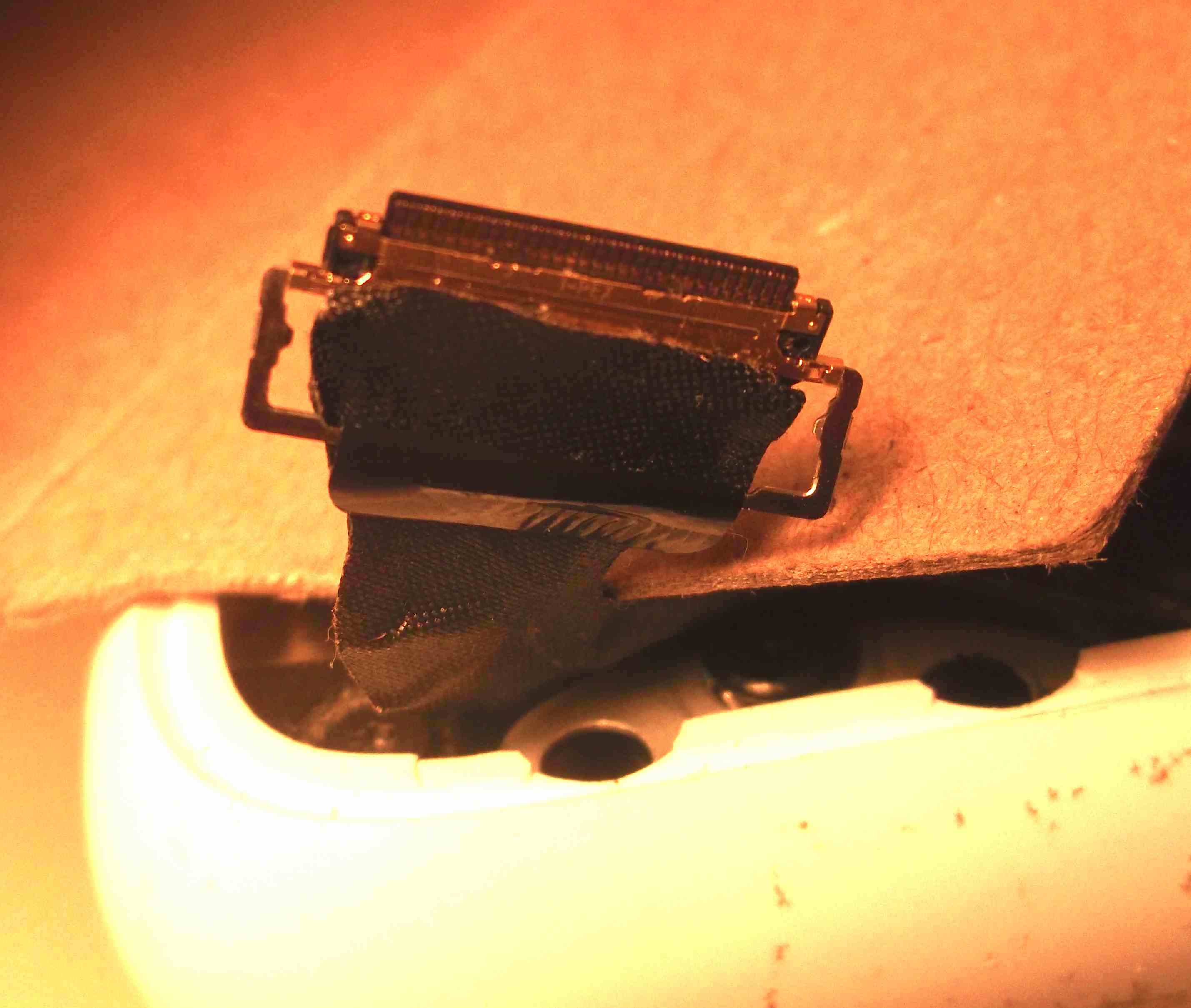

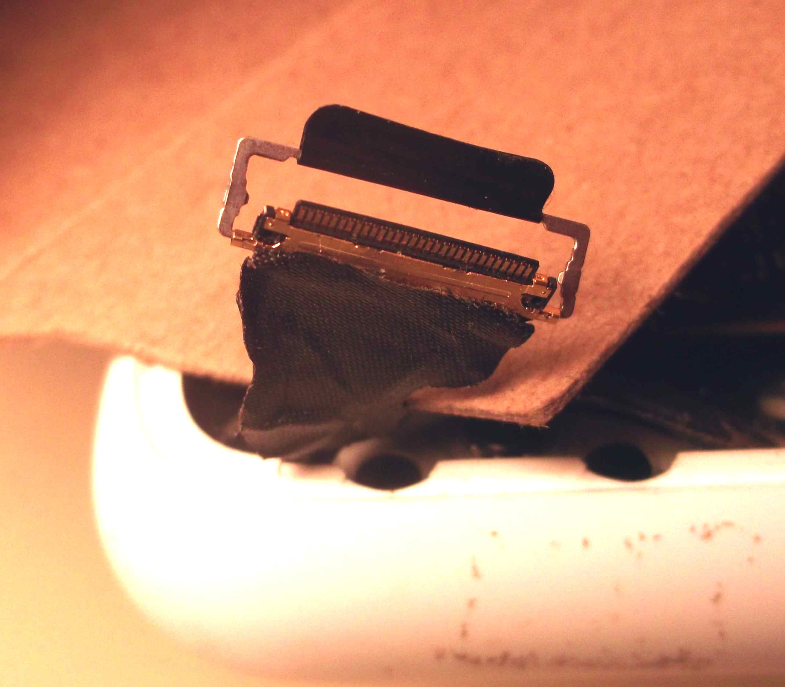

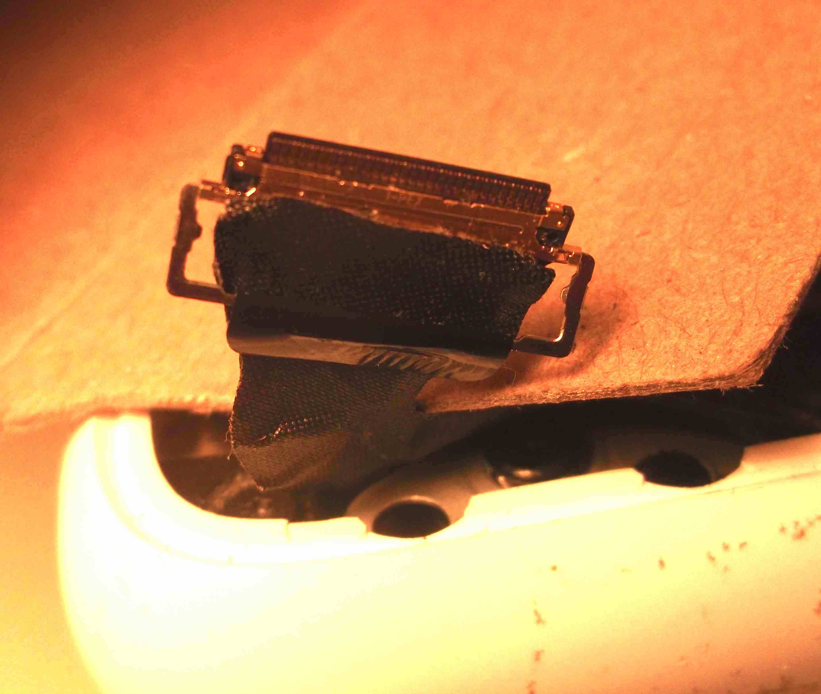

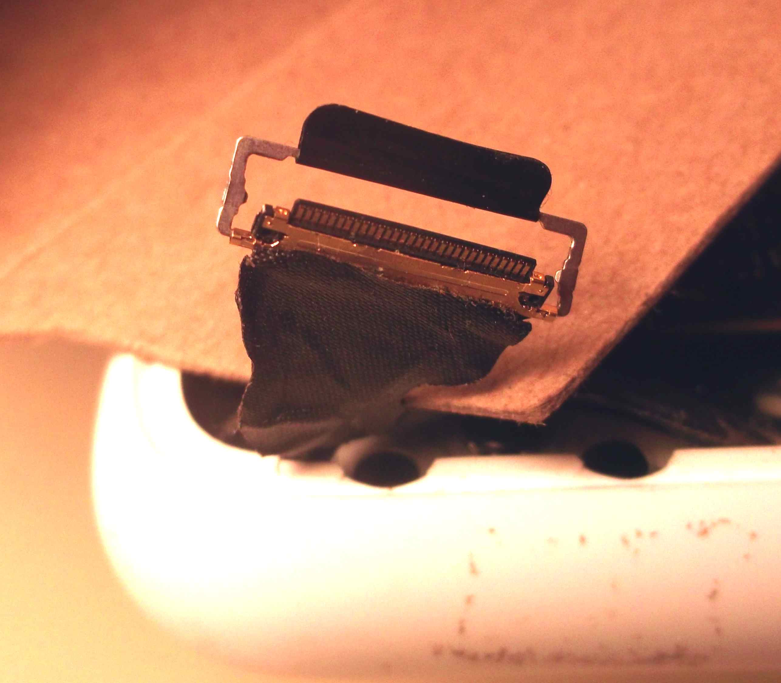

I've done lots of repairs using iFixit guides over the years and this is the first one that I would call "wrong". I'm sure the intentions were good and the pics were helpful, but you shouldn't do steps 7 through 16. Do step 6 then skip to step17. Doing the extra steps involves taking unneeded risks. The "display data cable lock" took me about 15 min to figure out what the #%&@$!!! they were talking about. I've attached two pics of that cable when disconnected. It has a metal loop that flips over - that's what you pull to remove it. The pics show that loop in two different positions. As usual, when you know how, it's easy.
Likely several Macs were permanently damaged by following the instructions in that guide.
Also, when I reinstall small connectors like on this job, and sometimes when I take them apart, I'll spray some Deoxit D5 on a Q-tip and apply a tiny amount to the connector. That probably saves many from breaking. I do the same with car electrical connectors.
