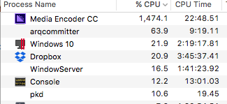

To check whether cpu is a problem check the CPU tab:
If the % CPU is more than the number of processors (I.E., 4 processors x 100% = 400%) then your cpu could be the bottleneck. If you see some process that is consuming all of your cpu then you might have a runaway process causing the problem. [I have 24 virtual CPUS so I know I'm in trouble if the total of the % CPU column > 2400%]. If you are just running Safari and mail you're probably OK. But if you're rendering that you may have it maxed out.
Before making an investment in upgrading hardware try to determine which component is the bottleneck. If it's your CPU then adding RAM or an SSD likely won't make much difference.
